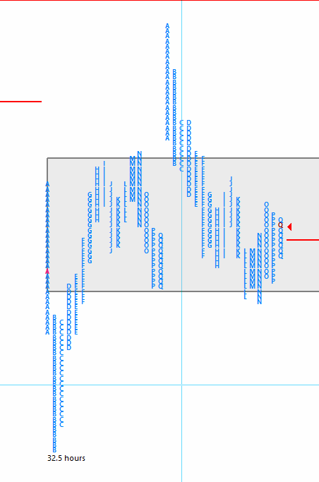

[2023-05-15 06:48:42]
AKR - Posts: 548
Like here. This is two full RTH sessions. what it shows is 32.5 hours. I would prefer to see just 2days or 2d or so.
Gets though more complicated when sessions are split like example two with 27.5 hours. At the time I did start the post tbh I did not think about splits.
imageScreen Shot 15.05.2023 at 08.44.png / V - Attached On 2023-05-15 06:44:42 UTC - Size: 15.71 KB - 311 views
imageScreen Shot 15.05.2023 at 08.46.png / V - Attached On 2023-05-15 06:48:29 UTC - Size: 18.64 KB - 319 views
