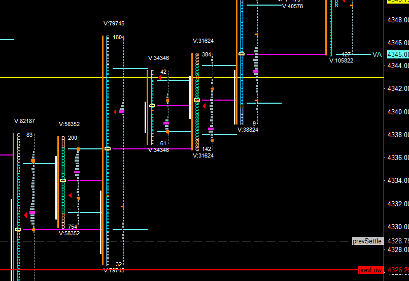

When i split the periods i have a different volume on top and bottom of that period compared to other people who have the same platform here with same datafeed and pkg.

We need some additional information on the exact setup you have and the values that you are seeing. A screenshot would also help us understand the particular issue.

when i split the periods, the volume at the very top and bottom is different than other people. For example, top of E period is 160, but all my colleagues have 48 on top of E.
Date Time Of Last Edit: 2021-10-13 18:37:37
imageScreenshot 2021-10-13 143418.png / V - Attached On 2021-10-13 18:34:39 UTC - Size: 36.4 KB - 308 views

Since what you are displaying is the Volume at the High and Low, those numbers are going to be affected by the TPO Letter/Block Price Increment in Ticks. In the chart you sent, this is set to 1. Make sure the other people that you are comparing to have the same setting.
Additionally, there are lots of other possibilities, including the Session Times and the VbP Calculation mode.
