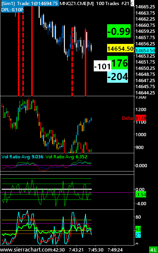

I can see lines updating on the chart using SS formula study but there are several problems:
I entered you formula =IF(AND(ID20.SG1[-1]<=50,ID1.SG1>50),C,ID20.SG1[-1]) un the formula input field. In my case ID20 is RSI TS.
I loaded this on a 100 tick bar. Im using Rithmic and Daneli. SC version 2299 64bit (38397M).
When the event triggers and RSI crosses up 50, I get a vertical line spanning from the last close of the bar downwards.
1 - Id like the line to capture only the last price at the event timing and stop updating (one event per bar). Right now if the event triggered at price 14700 and bar closes 14710 the line will continue to follow all the way to 14710 instead of remaining fixed at the original price when the event triggered). This is important for my trading concept/system.
2 - No matter which "Draw style" I choose in the subgraph configuration tab, only the first option "line" works. I wanted a horizontal line (just like what you get if you use "tools/horizontal line") and thought "Line at last bar left to right" will do it but neither any other option will.
Please advise
http://www.sierrachart.com/image.php?Image=1634129084465.png

In the mean time, I did what you said but it still dose not plot a horizontal line (Drawing style = line).
The spread sheet value is ID4 SG1.
It does plot the horizontal line but it disappears from the chart after a second or so.
Date Time Of Last Edit: 2021-10-13 13:44:16

I did just that and the horizontal line appears for sub second but disappears.
