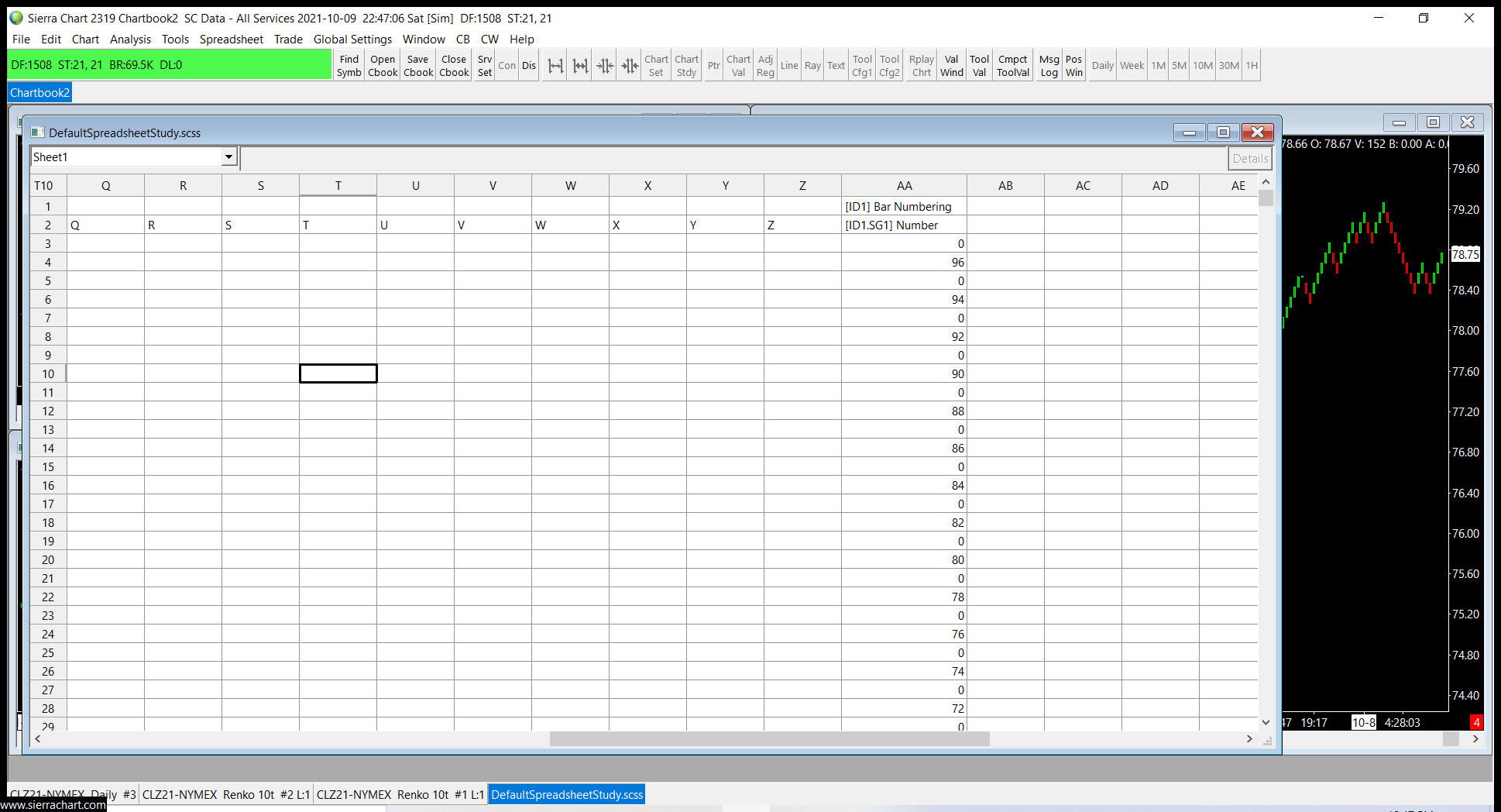

I don't want a separate studies output to be listed in my spreadsheet study. I have unmarked include in spreadsheet box in (settings an input) and in (subgraph of study) but still am getting output from study into my spreadsheet study. What do I need to do?

It is all dependent on the timing of when you selected the options to not display in the Spreadsheet.
If you had added the spreadsheet after you had deselected the option to Include in Spreadsheet, then the study would not show.
But, it sounds like the order of things in your case, was that you had the Spreadsheet added, which then put the study into the spreadsheet, and then you deselected the option in the Bar Numbering for Include in Spreadsheet. Since the data was already there, it was not removed (as you found out). Your options would be to either delete the column(s) of data or you could select Edit >> Reload and Recalculate.
[2021-10-11 01:50:10]
User841161 - Posts: 357
Edit>>Reload and Recalculate did not work. But was able to highlight column and right click and clear selection, instead of deleting whole column.
Also took out study altogether and tried to reload and recalculate, but all numbers from study stayed in column in Spreadsheet study, which I thought was weird. Would have thought if study was deleted, it would be deleted from spreadsheet study because at that point the study didn't even exist?
[2021-10-11 02:53:07]
No, this is not the case. Refer to:
Using the Spreadsheet Study: Clearing Old Study and Other Data from Spreadsheets
