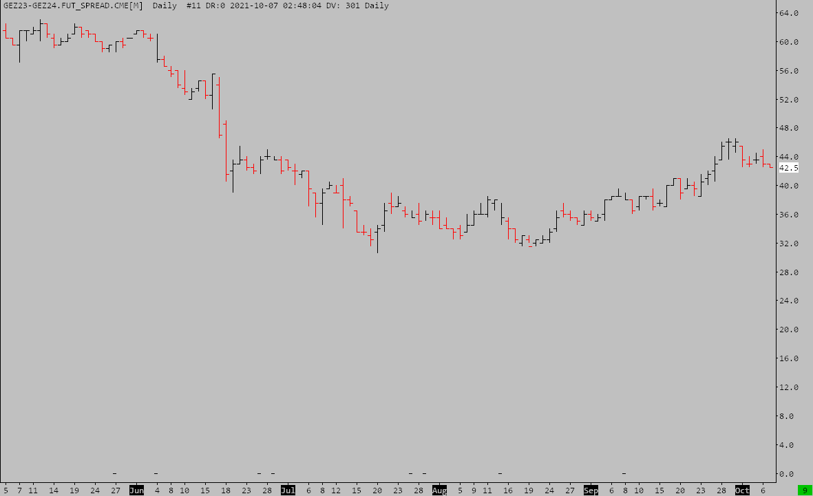

Dear Support,
On the below historical chart, the GEZ23-Z24 Eurodollar spread displays multiple strange open prices (zero as open price).
This happens with the Historical chart only. I tried to delete and re-download data, but it did not help - this is also an issue for other users.
Can you please check and advise, how this can be fixed?
Thank you in advance.
http://www.sierrachart.com/image.php?Image=1633589599376.png
Date Time Of Last Edit: 2021-10-07 07:17:17
[2021-10-07 14:54:32]
It will take some time for us to look into the cause. We are aware of some inconsistencies between the servers with the historical daily data, in particular spread data. If you were to re-download the data in the chart, once or twice it would correct itself.
For now just uncheck this option:
Chart Settings: Allow Zero Values (Chart >> Chart Settings >> Chart Data >> Chart Data menu)
[2021-10-07 15:38:35]
ticinotrader - Posts: 431
Perfect, thank you. Re-downloading did not help, but turning off the 'Allow Zero Values' option works like a charm.
