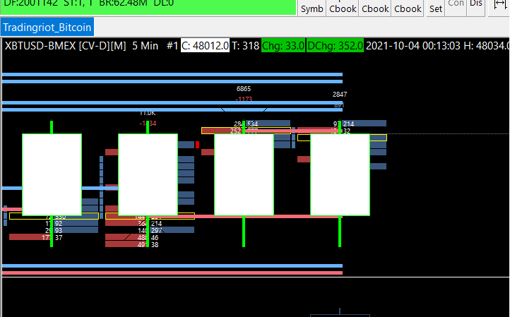

How do get the candle outline on my numbers bar like in the attached image.
imageatrade1.jpg / V - Attached On 2021-10-03 08:46:38 UTC - Size: 357.33 KB - 486 views

Have the underlying chart setup to have that type of candlestick (Candlestick Hollow), then after the Numbers Bars study has been added, ad the Study/Price Overlay and overlay the Main Price Graph from that chart. Refer to the following information for the Study/Price Overlay:
Study/Price Overlay Study

Thank you i have the candles now. How do i make the candles transparent so i can see the values?
imagecandles2.png / V - Attached On 2021-10-03 22:14:15 UTC - Size: 15.51 KB - 287 views
[2021-10-03 22:28:19]
We are not sure why you are getting that White fill like that.
Is the Main Price Graph data set to display the "Candlestick Bars Hollow"?
Did you change anything on the Study/Price Overlay that would change this (you should not have had to change anything, just select the Study to overlay)?
[2021-10-04 05:32:38]
Moodzy89 - Posts: 7
its working now, i was using the wrong graph for data. Thank you for the help
