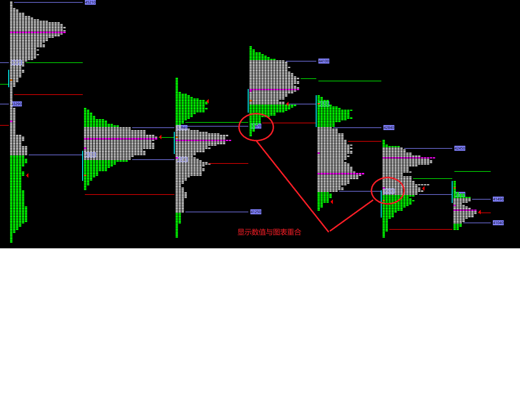

TPO数值与图表重合,如何调整?
image无标题.png / V - Attached On 2021-09-30 13:36:24 UTC - Size: 44.06 KB - 367 views

From Google Translate:
The TPO value coincides with the chart, how to adjust?
It looks like you are using the "Value Label" for the "Value Area Extension Lines". If we have this correct, then you just need to change the Horizontal Alignment setting for that subgraph to Left. Or try other options and see if there is one you like best. Refer to the information here:
Chart Studies: Subgraphs Tab >> Name and Value Labels
