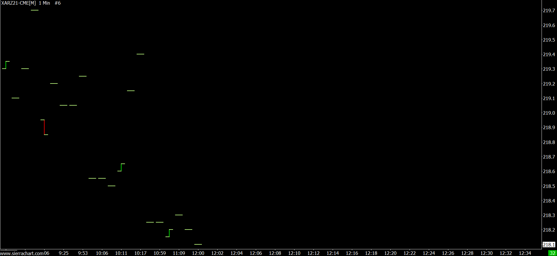

[2021-10-04 17:41:48]
It's not a very well traded instrument, but there is some data. The following is what we see, and is what you should have your chart as well for the Z contract:
http://www.sierrachart.com/image.php?Image=1633369230381.png
If you are not getting this, then get us your message log by following these instructions:
