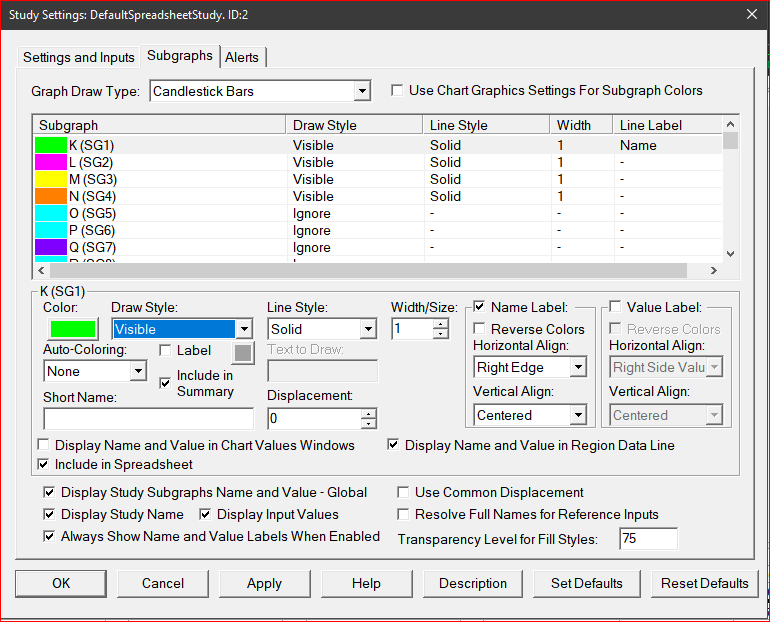

Sawtooth - Posts: 4359
Each spreadsheet row is a chart bar, with the current bar in row 3 and earlier bars in rows below.
If you want historical bars, you cannot limit the plot to only row 3.
With 'Use Price Graph Style' set to Yes, you should get this on the Subgraphs tab: See pic.
