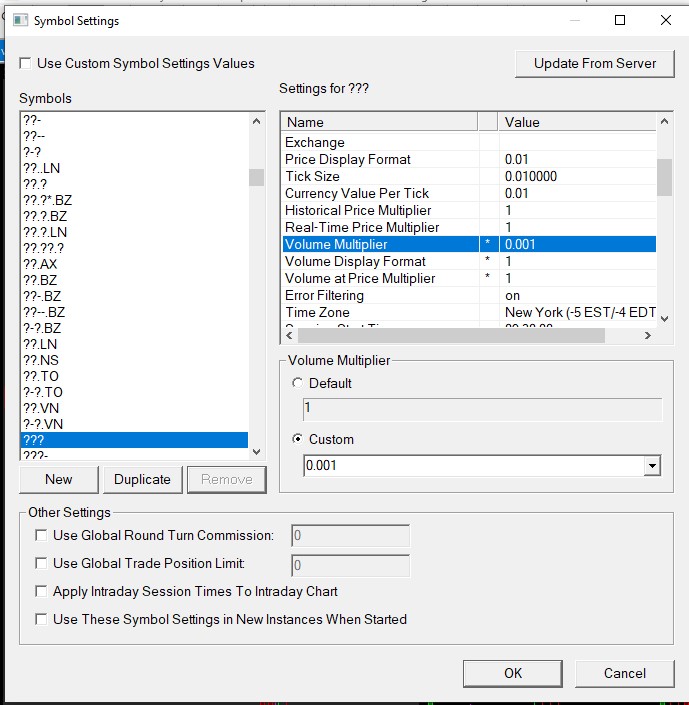

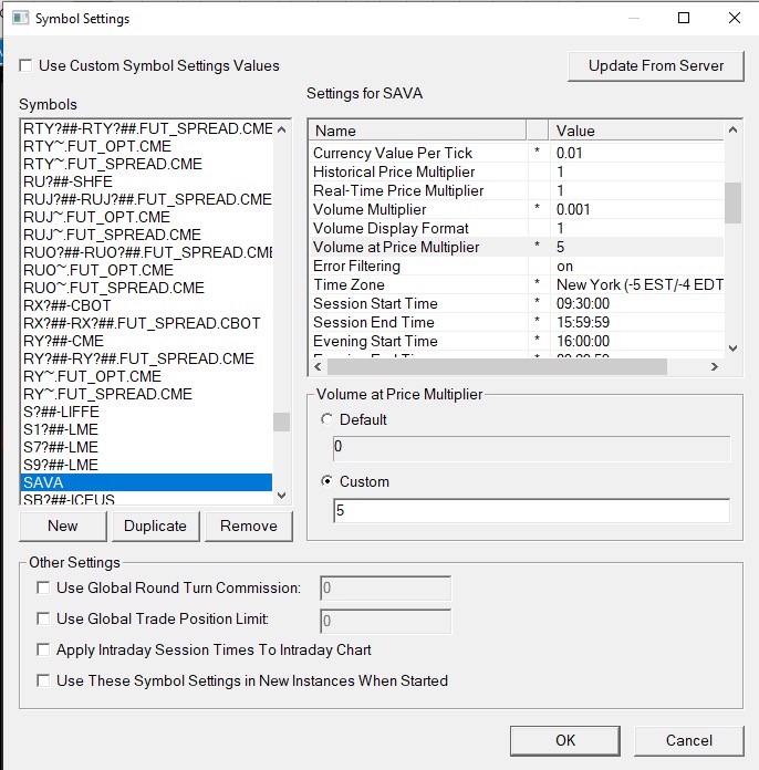

Yes, disabling the custom symbol settings appears to restore functionality to the chart, but then I lose the customizations made to settings like Volume at Price Multiplier and Volume Multiplier that I customize for certain names.
When I made a symbol specific Custom Symbol Setting entry, I copied the settings using the Duplicate button from the `???` wildcard records. Could this be creating the issue? Do I need to customize the settings for AMC or SAVA differently than what is set for ?, ??, ???, etc?

There is a setting you need to set called Use Pattern Matching . That needs to be enabled in the symbol settings for the symbol. That should resolve the problem.
