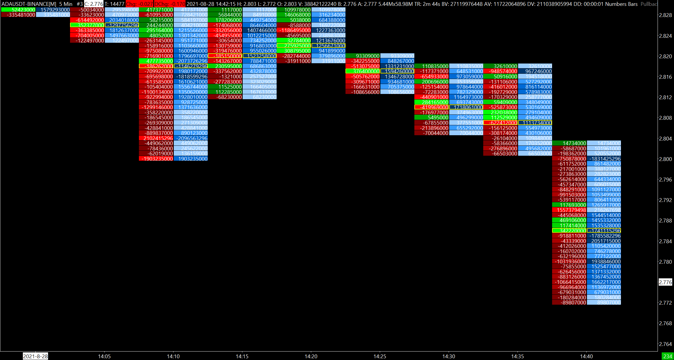

Trying to shorten the big numbers that appear with ADAUSDT pair on Binance using Numbers Bars Chart.
I select "Study Settings => Value Format => Large Integer With Suffix" but nothing changes and the number stays as they were.
Can also ask why in the second (blue) column where I have selected the values text to be volume the values appear to be negative? Negative Volume? how is that possible?
http://www.sierrachart.com/image.php?Image=1630161737335.png
Thanks for any help.
Sergio
imageCapture.PNG / V - Attached On 2021-08-28 14:41:02 UTC - Size: 307.03 KB - 373 views
[2021-08-28 15:14:31]
John - SC Support - Posts: 47939
For the Numbers Bars, you need to set the Input for Use Large Volume Number Formatting to Yes. Changing the Value Format will not make the change. Refer to the following for this Input:
Numbers Bars: Use Large Volume Number Formatting
With regards to the negative volume values, we do see this occurring after the first column is changed to "AskVol BidVol Difference". Before that, the Total Volume display, if displayed in the First column, is correct. We also noticed that it continues to use those incorrect volume numbers even if the Numbers Bars is removed and added back. We will look into this.

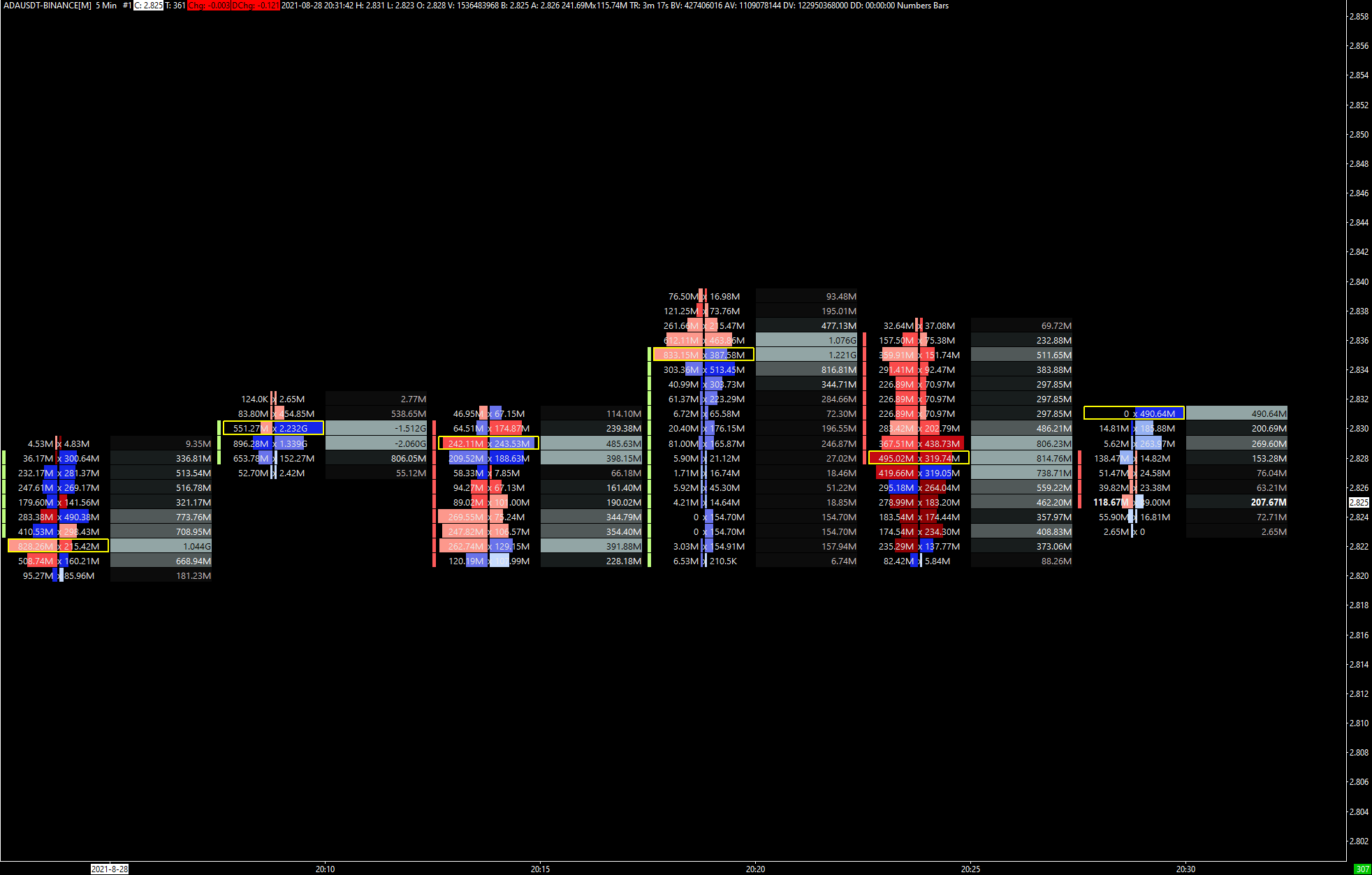

here is the chart:

[2021-08-29 09:25:57]

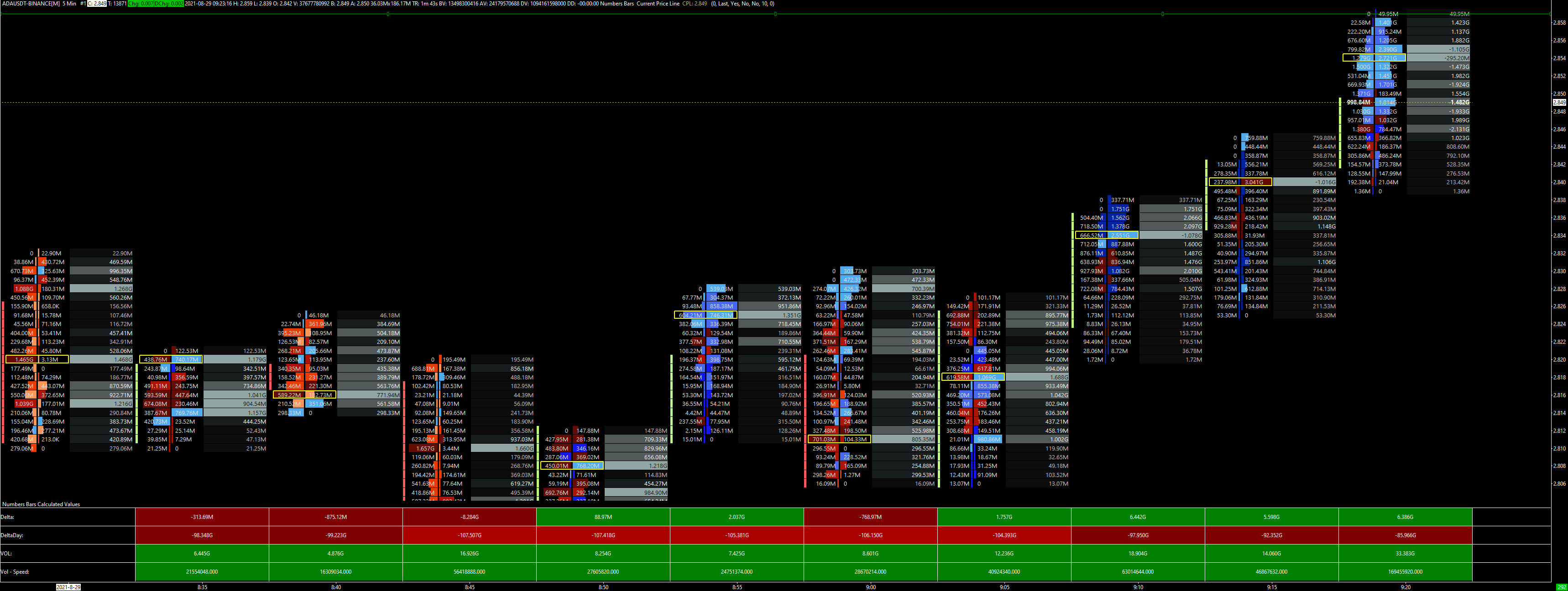

in this case: http://www.sierrachart.com/image.php?Image=1630228998205.png
the negative volume affected the coloring of the background (Background Colouring Based on AskVol BidVol Diagonal Difference Percentage of Bar Range) as in the second last bar at the POC at the offer of 3G should have been coloured in blue as the diagonal bid was hit from only 400M.
