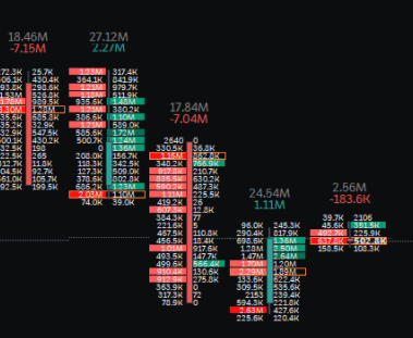

Just wondering if it was possible to see the Overall Delta and Volume of an individual Number Bar. Been looking for the correct setting but cannot seem to find. Thanks. Example below.

You can add a "Numbers Bars Calculated Values" study to calc the volume/delta of each bar. Then to display the text use a "Study Subgraph Above/Below Bar as Text" study that references the required subgraph from the calculated values study.
