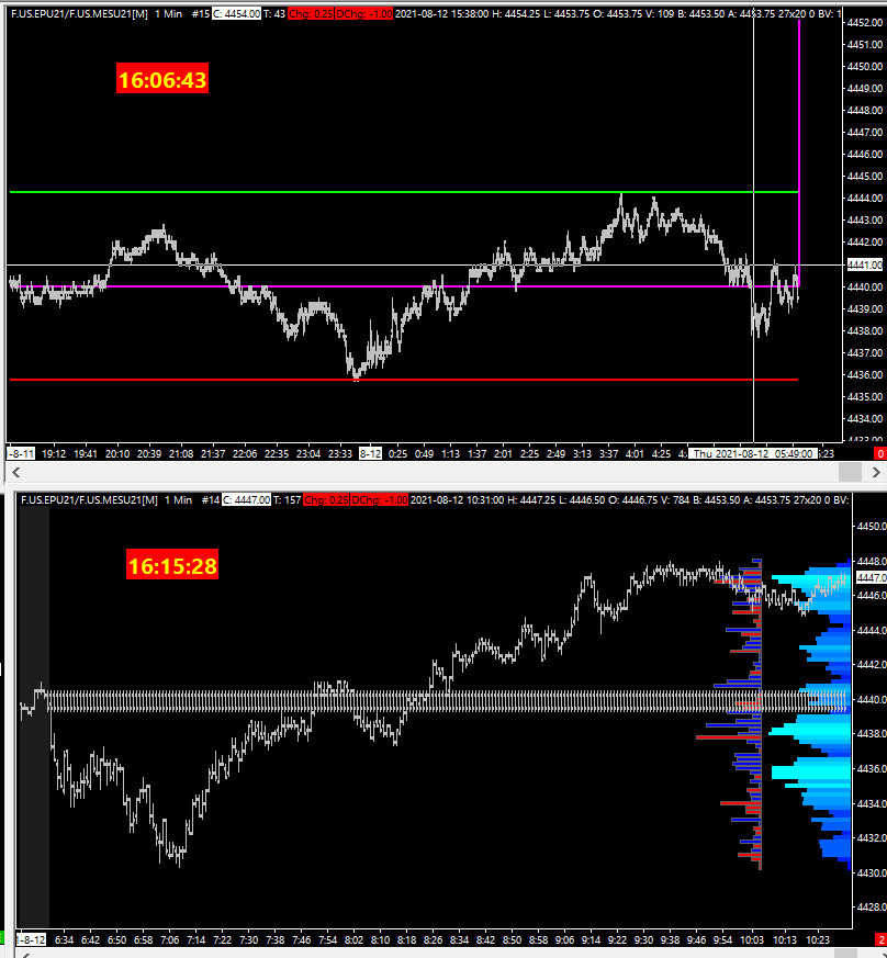

I did as you said and the attached image is the result. The bottom chart is my main chart and the top one is the excess chart where I made it only have ON data and the value lines. All that changed was I got that white line in the middle of my charts instead of the value lines. What did I do wrong?
imageScreenshot 2021-08-12 161548.png / V - Attached On 2021-08-12 23:16:13 UTC - Size: 40.54 KB - 273 views

John - SC Support - Posts: 48431
Get us that Chartbook so we can take a look and tell you what is happening. Follow these instructions to attach the chartbook:
