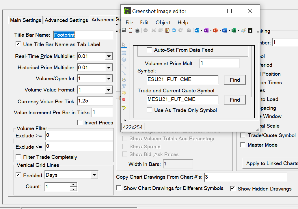

Sierra's "Chart Stats" has me with 4 lots at -$350, as if I traded the Mini instead of the Micro. Reviewing the photo of "Chart Stats", it looks like I traded 4 lots, which I did not. The closed P/L is odd also.
It was working fine the day before. I checked the "Chart >> Chart Settings >> Advanced Settings 2 >> Currency Value per Tick" and ensured it is set correctly. "Trade and Current Quote Symbol" is correct also.

Go to chart #4 and let us know what this setting is set to:
Chart Settings: Currency Value Per Tick (Chart >> Chart Settings >> Symbol >> Symbol Settings menu)
At the top of the Trade Activity Log, for the P/L Format what is it set to? Make sure it is set to Currency Value.

My apologies, I had to step away for a few days. See enclosed, the "Currency Value Per Tick" 1.25.
See enclosed.
imageCurrency Value Per Tick.png / V - Attached On 2021-08-17 15:03:32 UTC - Size: 65.57 KB - 286 views
[2021-08-17 15:20:34]
But that is the number #2 chart. Not the number #4 chart. There is a difference.

Ok, that must be the issue, Chart 4 was at 12.5 per tick. Thank you!
Now, I've never traded off chart #4. Why would the trade activity log choose that chart over #2, where the trades actually took place?
