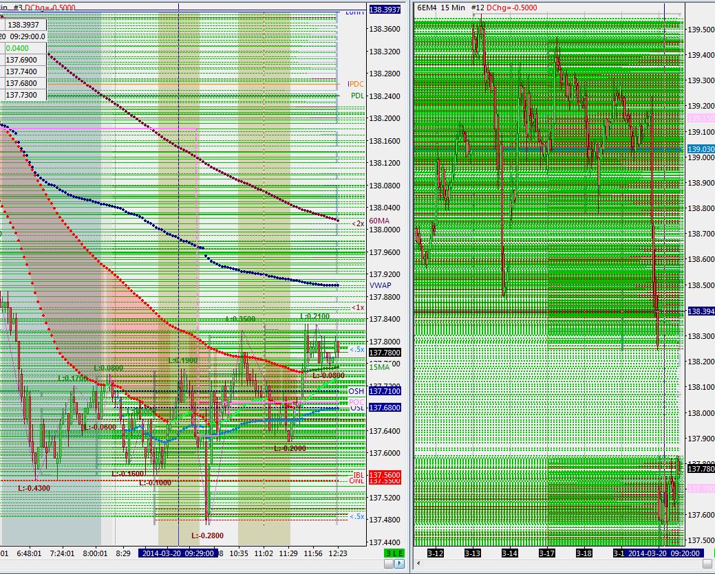

I copied my old data file to separate location for backup. I then followed you instructions of delete all and download. The results were as I suspected resulting in the following issues.
1. the data is back to the format 139.00 not the format of 1.3900 which is what I was told yesterday afternoon, by you, was the correct formatting.
2. this deletes a substantial portion of my data that I have maintained and obfuscates much of the correct data since the current contract
3. there is clearly something wrong since there are hundreds if not thousands of lines all over my chart that were not there before.
4. after doing this SC is now consuming 2.6+Gb memory per task manager. prior to doing as you instructed it was less than 1Gb.
I DO NOT want to delete all my old data, so therefore there must be a solution other than delete and download ALL. It makes no sense to be required to do that. All that needs updated is from yesterday afternoon, not from the beginning of time. As I explained I adjusted all my old data yesterday with a multiplier to match the new format and therefore all I need is the data going forward.
Date Time Of Last Edit: 2014-03-20 16:41:40
imageupload.JPG / V - Attached On 2014-03-20 16:27:46 UTC - Size: 401.23 KB - 583 views

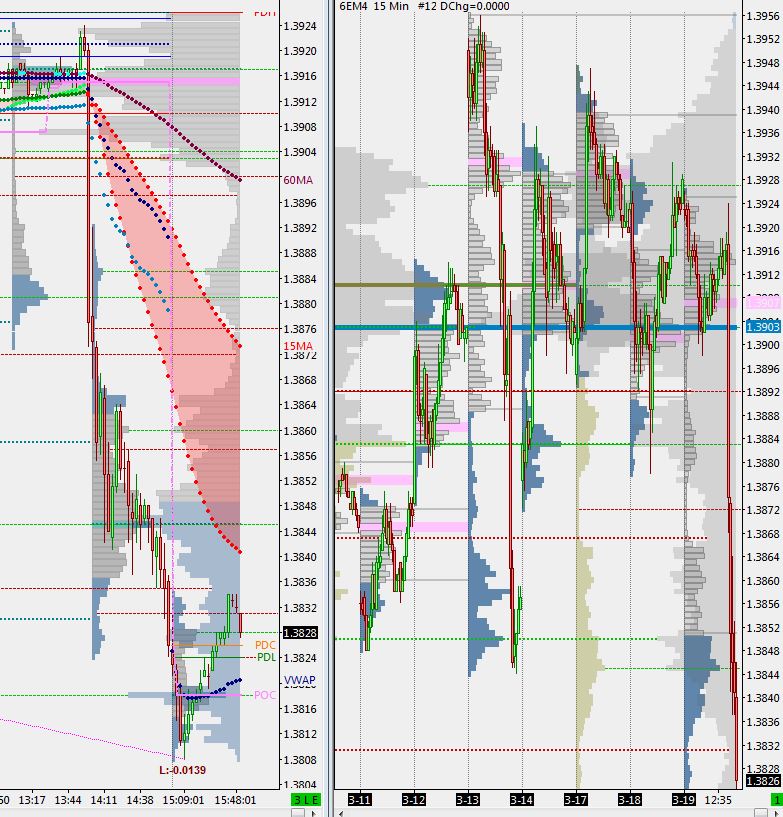

[2014-03-20 16:34:15]
NRGTrader - Posts: 351
example of the same charts with MY data before doing the edit delete all and download

[2014-03-20 20:10:23]
1. The correct format for now, will be the original data format that has long been used by OEC. So what you see is correct.
Refer to this page about this problem:
OEC Currency Futures Data
3. This might have something to do with the tick size of the chart not being correct. Update to the latest symbol settings and apply them to the charts as explained here:
https://www.sierrachart.com/index.php?l=doc/doc_GlobalSymbolSettings.php#UpdateSettingsSteps
4. Refer to help topic 30.1 here:
https://www.sierrachart.com/index.php?l=doc/helpdetails30.html#h30.1
