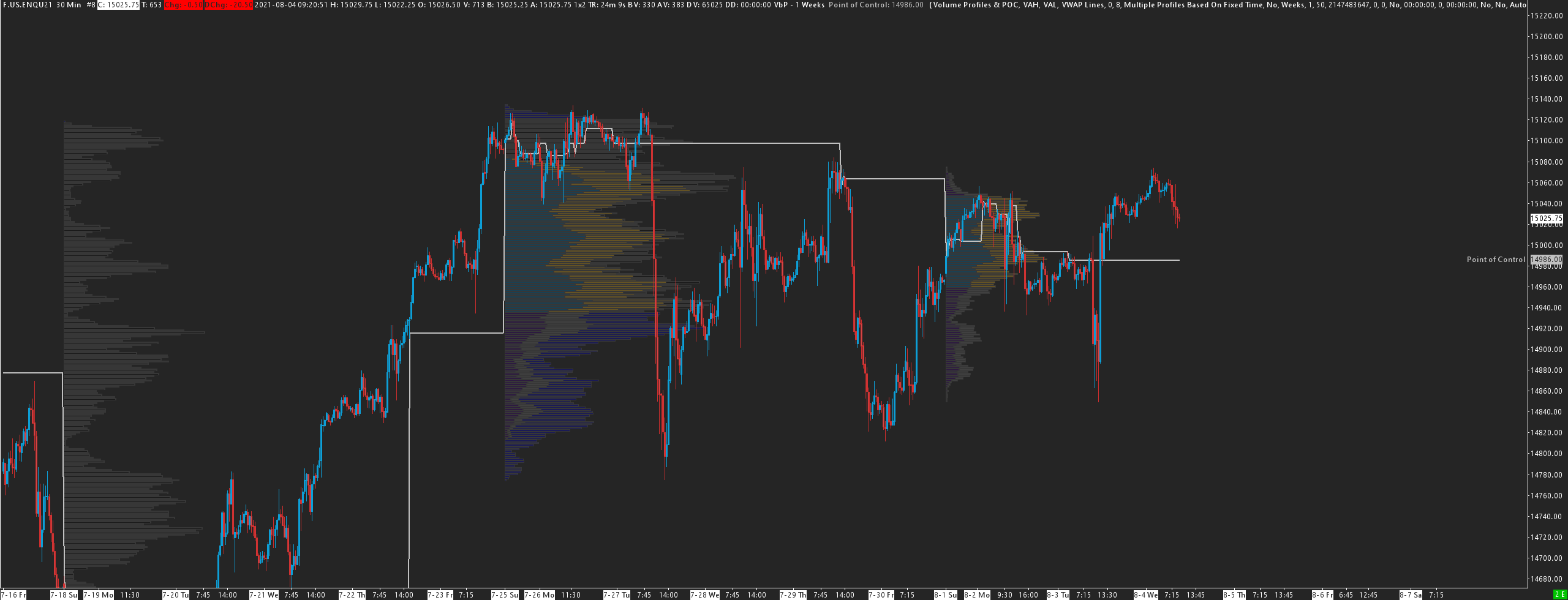

I'm not sure why this happens, I have it set to a weekly VBP. This week's profile looks just fine, but there is overlap in certain settings for last week's profile and then it's completely black for the week before it.
This is not intended, and I'd like for all weeks to look like the most recent VBP study.

Truthfully, we are little confused by what you are seeing, as the main reason for the all black profile is that the bars are so small that the system can not draw any coloring in them. But what is odd is that you can see color in the first two profiles.
Still, try changing the Ticks per Volume Bar to a larger value until you get what you want. Refer to the information here:

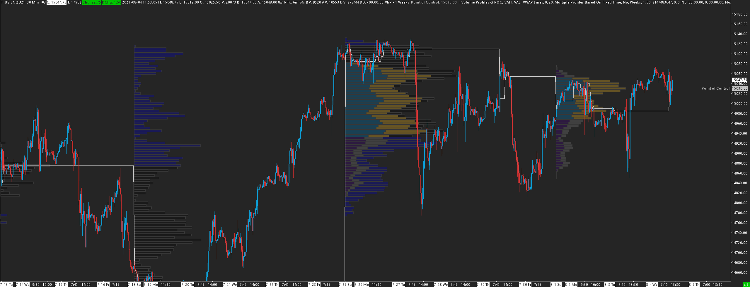

Thanks John,
It doesn't matter what I set it to. Here I have it at 20 ticks per volume and it's still the same result

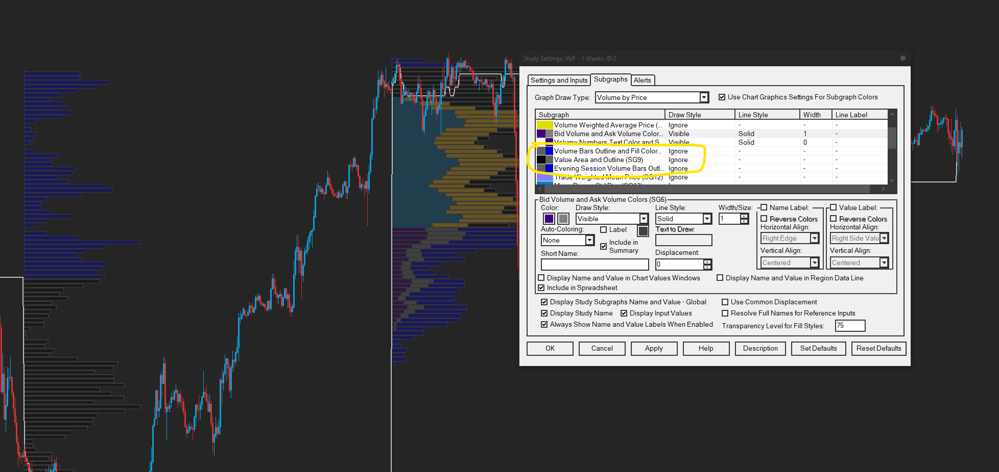

I also uploaded a screenshot to show you the subgraphs settings (circled in yellow). I'm trying to find the source of these colors and even then, I have set the draw style to Ignore yet they still show.

I definitely see a difference with the value of 20 for the Ticks per Volume Bar, in that you can see the blue at the top of that profile on the left.

We have no idea why you are seeing what you are. It really does not make any sense given the setup you sent us. Here is what we see when we adjust things a bit so you can see all the profiles at once (we turned off the candlesticks and set the VbP display to just be the profiles and set the Ticks per Volume Bar to 20 and set it to not be transparent).
But we never had it showing anything like what you had in your original images. At first we were wondering if you were displaying the Ask and Bid as Ask Bid Difference and then using the Draw Difference of Bid Ask Volume Using Percent Of Max Volume, which could give you the effect you are seeing in the middle profile.

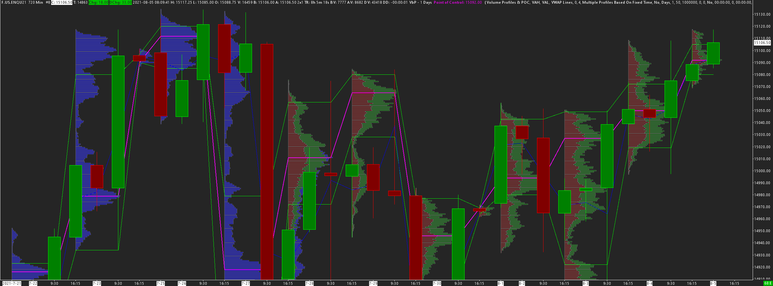

http://www.sierrachart.com/image.php?Image=1628165384867.png
Here is a 12 hour chart using the default subgraph settings for VBP

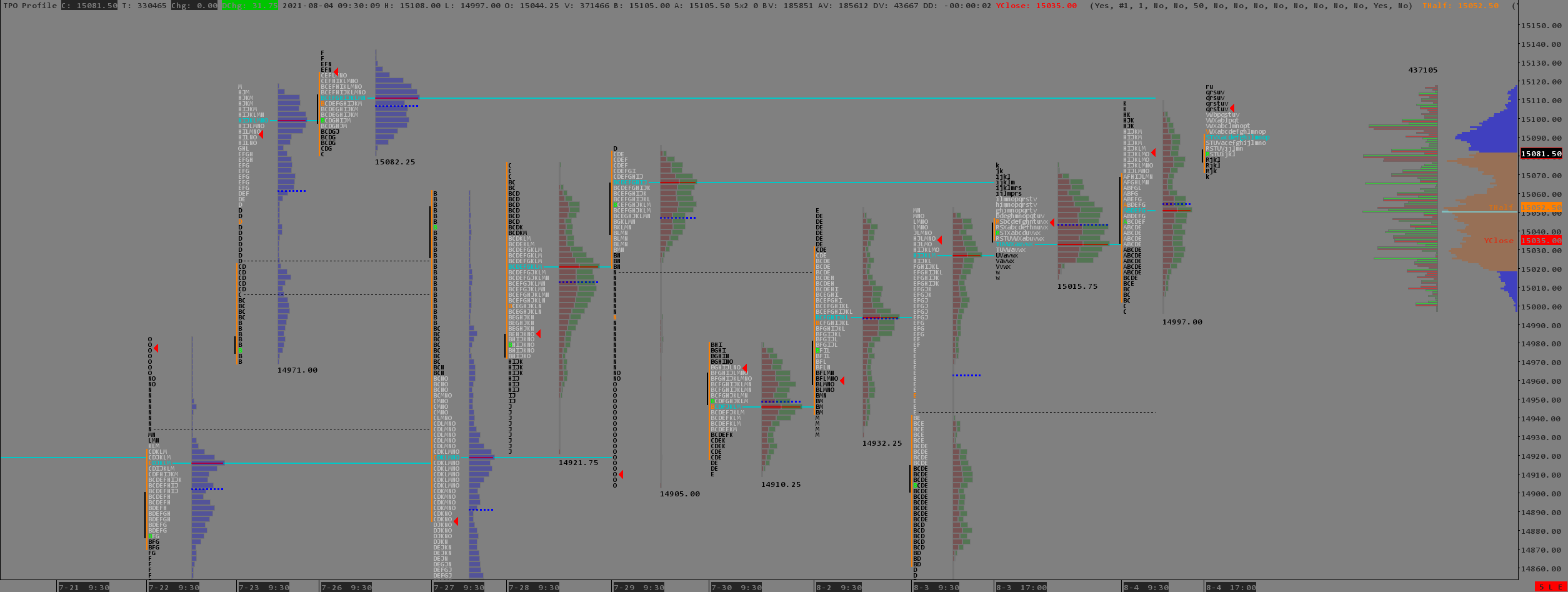

Here is a TPO chart using VBP and you'll notice the same issue in the Volume profiles. It's weird.
http://www.sierrachart.com/image.php?Image=1628165677199.png

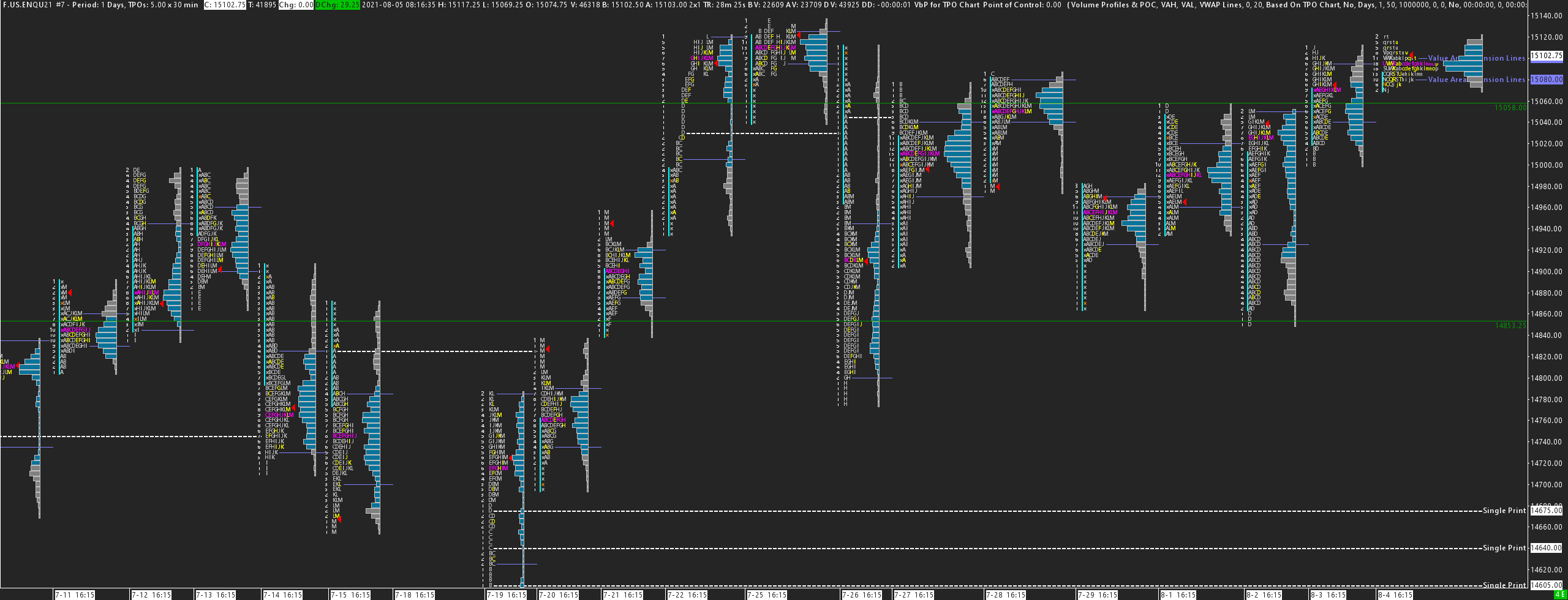

Here is another TPO chart without the issue...
http://www.sierrachart.com/image.php?Image=162816579830.png

It's the Volume bar coloring method. This only happens when splitting the color between bid/ask

It sounds like you have the right idea, that somehow the Bid and Ask data is not present in the historical data before 1 week ago. To check this add a Numbers Bars study to a chart and set the Numbers Bars Text to Bid Vol x Ask Vol and set the Background Coloring Method to None.
Our guess is that you will just have zeros for the data in the area where you are having an issue with the VbP.
If this is the case, then it is an issue with your data feed. We recommend using the Denali Exchange Data Feed instead. Refer to the information here:
