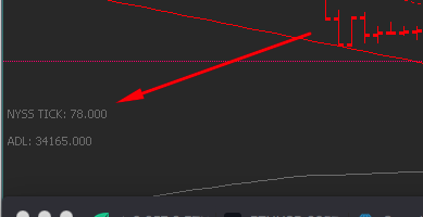

Hello I have a study price overlay for the NYSS put in my central graph and another for the NYSS in the same graph I have it configured that is based on the closing if it is above green and below red the problem is that in the graph of I work the study overlay does not replicate the original at the closing of the candles. I would like to know if you can get them to change color or that configuration is basically impossible.

We are not fully understanding your setup and what you are trying to accomplish.
In general though, you need to look at the data that you are getting from the Study/Price Overlay and ensure that it is correct for what you are copying. Be sure to adjust the Data Copy Mode and Bar Time Matching Method for how you want to get the data into the chart. Refer to the information starting here:

Ok!Solved!!
thank you for you support!!
