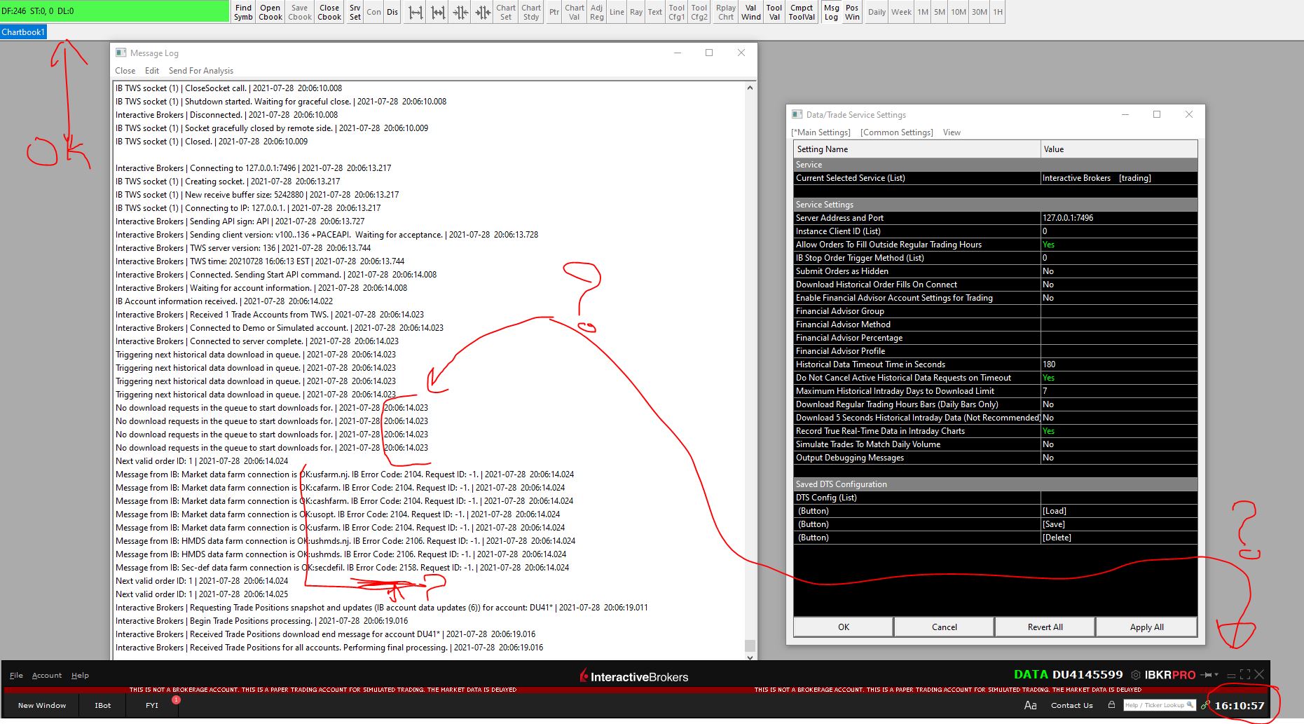

now i test your sierra chart free 15days with interractive brokers simulate
check picture .. i have not same time .. and error code ?

The items you show in the image are not errors, they are just informational notes about the status of the connection. Everything is showing correctly and is not a problem.
