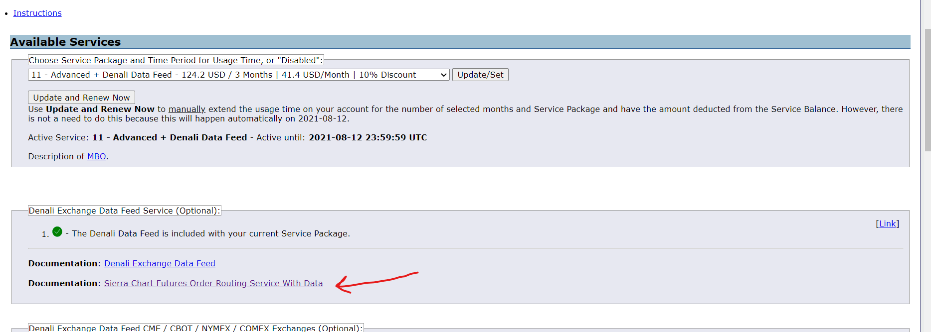

If I change my current selected service to CQG Wep api, I will still be using sierra Denali for my data correct? It says in image below I have sierra order routing service as well, shouldn't I be using this?
That is just a link to the documentation for that service. It is not stating that you are using that service. You are not using the Sierra Chart Order Routing Service, nor can you be, as it is not supported with AMP.
