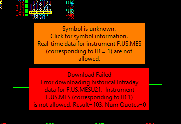

[2021-07-15 20:35:38]
User626674 - Posts: 5
Habe alles wie beschrieben gemacht. Diese Fehlermeldung im Anhang wird angezeigt.
"Symbol is unknow. Click for symbol information Real-time data for instrument F.US.MES (corresponding to ID=1) are not allowed."
"Download Failed Error downloading historical Intraday data for F.US.MESU21. Instrument F.US.MES (corresponding to ID1) is not allowed. Result=103. Num Quotes=0"
imageFehlermeldung.PNG / V - Attached On 2021-07-15 20:29:28 UTC - Size: 10.27 KB - 266 views
[2021-07-16 17:22:09]
"Symbol ist unbekannt. Für Symbolinformationen anklicken Echtzeitdaten für das Instrument F.US.MES (entsprechend ID=1) sind nicht zulässig."
"Download fehlgeschlagen Fehler beim Herunterladen historischer Intraday-Daten für F.US.MESU21. Instrument F.US.MES (entspricht ID1) ist nicht zulässig. Ergebnis=103. Num Quotes=0"
AMP sagt es liegt an Sierra Chart, aber CQG orderrounting geht nicht. Ich kann immer noch nicht live trading.
[2021-07-16 19:58:15]
John - SC Support - Posts: 48579
The problem at this point is that you do not have any exchanges activate on the Denali Exchange Data Feed. The exchanges you had did not renew on July 1, 2021 since you did not have enough funds in your account at that time to have them automatically renew.
To reactivate the same exchange(s) you had previously, select the following link and login to the Sierra Chart website if necessary, then scroll to the bottom of the page and select the button for Reactivate Exchange for the exchange(s) you want to reactivate.
https://www.sierrachart.com/UserControlPanel.php?page=RecurringServices
