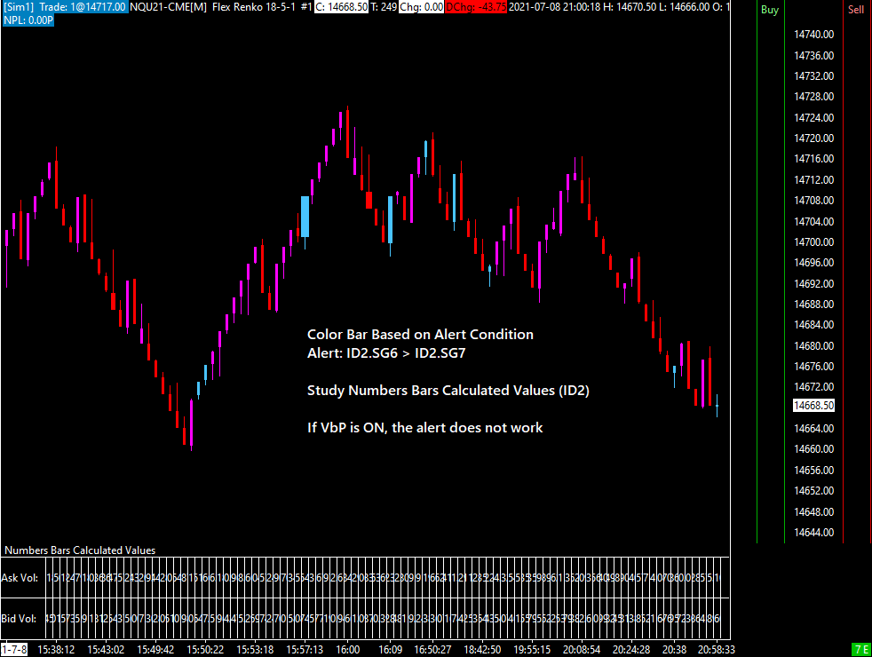

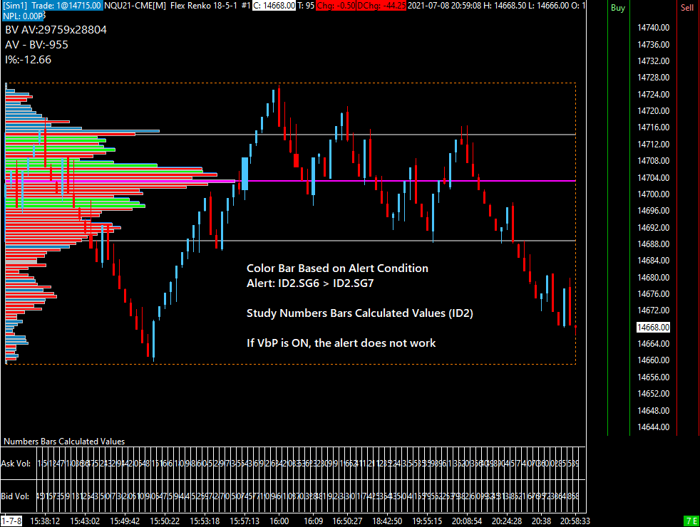

When I use the Study Color Bar Based on Alert Condition or my own ACSIL to color bars or Color Bar HH/LL they dont work when Volume by Price is ON or when I use Tool > Draw Volume Profile.

imageVbP on Chart.png / V - Attached On 2021-07-08 18:43:45 UTC - Size: 29.16 KB - 418 views

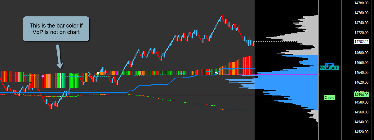

1) Im uploading the chartbook and the screenshot.
http://www.sierrachart.com/image.php?Image=1625792352986.png - With VbP on
http://www.sierrachart.com/image.php?Image=1625792424672.png - With VbP off

With regards to the Color Bar issue, we can see the issue in the Chartbook you supplied, but it should not be occurring. If we start a new chart and put everything on it in the same way, then the problem is not showing. This leads us to believe there is some kind of a corruption of that chart.
Please try putting on a completely new chart and recreate what you had before. Do not duplicate the old chart, just start new.
That worked for me... I really dont know why that was happening.
