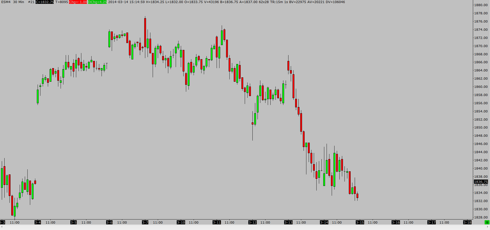

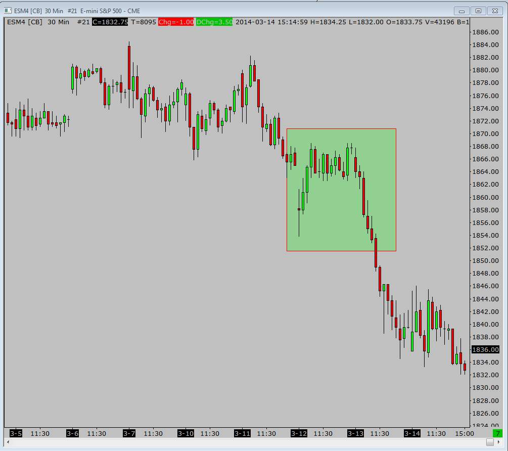

I use infinity + Sierra chart. On the 1st chart there is simple ESM4 chart (without premarket). On the 2nd chart is ESM4 [CB] chart. This 2nd chart is the same after performing futures rollover. Until 12.3.2014 all candles should be down by 7 points (as on the 1st chart), but they are not. I can`t perform rollover due to this, and don`t know what to do. Please help. I have version 1107.

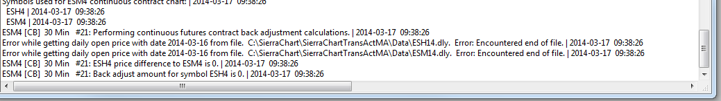

will this help you to help me somehow?
ESM4 [CB] 30 Min #21: ESH4 price difference to ESM4 is 0. | 2014-03-17 09:38:26
ESM4 [CB] 30 Min #21: Back adjust amount for symbol ESH4 is 0. | 2014-03-17 09:38:26
Date rule based rollover from ESH4 to next contract occurs at 2014-03-13 | 2014-03-17 09:42:03
Date rule based rollover from ESM4 to next contract occurs at 2014-06-12 | 2014-03-17 09:42:03
Checking Intraday data file for symbol ESH4 for the date range from 2013-12-12 to 2014-03-13 | 2014-03-17 09:42:03
Daily data file for symbol ESH4 existed and is empty. Skipping download. | 2014-03-17 09:42:03
Checking Intraday data file for symbol ESM4 for the date range from 2014-03-13 to 0 | 2014-03-17 09:42:03
Daily data file for symbol ESM4 existed and is empty. Skipping download. | 2014-03-17 09:42:03
Symbols used for ESM4 continuous contract chart: | 2014-03-17 09:42:03
ESH4 | 2014-03-17 09:42:03
ESM4 | 2014-03-17 09:42:03
ESM4 [CB] 30 Min #21: Performing continuous futures contract back adjustment calculations. | 2014-03-17 09:42:03
Error while getting daily open price with date 2014-03-16 from file. C:\SierraChart\SierraChartTransActMA\Data\ESH14.dly. Error: Encountered end of file. | 2014-03-17 09:42:03
Error while getting daily open price with date 2014-03-16 from file. C:\SierraChart\SierraChartTransActMA\Data\ESM14.dly. Error: Encountered end of file. | 2014-03-17 09:42:03
ESM4 [CB] 30 Min #21: ESH4 price difference to ESM4 is 0. | 2014-03-17 09:42:03
ESM4 [CB] 30 Min #21: Back adjust amount for symbol ESH4 is 0. | 2014-03-17 09:42:03
Date rule based rollover from ESH4 to next contract occurs at 2014-03-13 | 2014-03-17 09:42:21
Date rule based rollover from ESM4 to next contract occurs at 2014-06-12 | 2014-03-17 09:42:21
Checking Intraday data file for symbol ESH4 for the date range from 2013-12-12 to 2014-03-13 | 2014-03-17 09:42:21
Daily data file for symbol ESH4 existed and is empty. Skipping download. | 2014-03-17 09:42:21
Checking Intraday data file for symbol ESM4 for the date range from 2014-03-13 to 0 | 2014-03-17 09:42:21
Daily data file for symbol ESM4 existed and is empty. Skipping download. | 2014-03-17 09:42:21
Symbols used for ESM4 continuous contract chart: | 2014-03-17 09:42:21
ESH4 | 2014-03-17 09:42:21
ESM4 | 2014-03-17 09:42:21
ESM4 [CB] 30 Min #21: Performing continuous futures contract back adjustment calculations. | 2014-03-17 09:42:21
Error while getting daily open price with date 2014-03-16 from file. C:\SierraChart\SierraChartTransActMA\Data\ESH14.dly. Error: Encountered end of file. | 2014-03-17 09:42:21
Error while getting daily open price with date 2014-03-16 from file. C:\SierraChart\SierraChartTransActMA\Data\ESM14.dly. Error: Encountered end of file. | 2014-03-17 09:42:21
ESM4 [CB] 30 Min #21: ESH4 price difference to ESM4 is 0. | 2014-03-17 09:42:21
ESM4 [CB] 30 Min #21: Back adjust amount for symbol ESH4 is 0. | 2014-03-17 09:42:21
