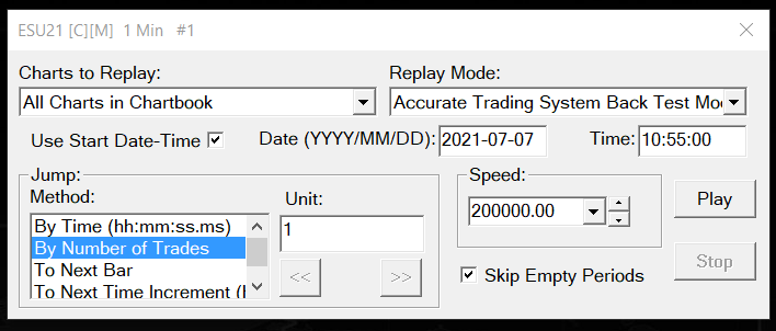

Manual Replay settings:
Mode: Accurate
Use Start Date-Time: true
Speed: 200000
Skip Empty Periods: true
Problem: I need a reliable way to determine that I am backtesting. Is there is another method/property to determine this?

Below is a log showing all study calls during a replay from 7/7/21 10:55
The last tick of available data is at 10:59:14
The study is set for manual looping
The chart is configured for 1 minute bars
Sierra Chart is disconnected

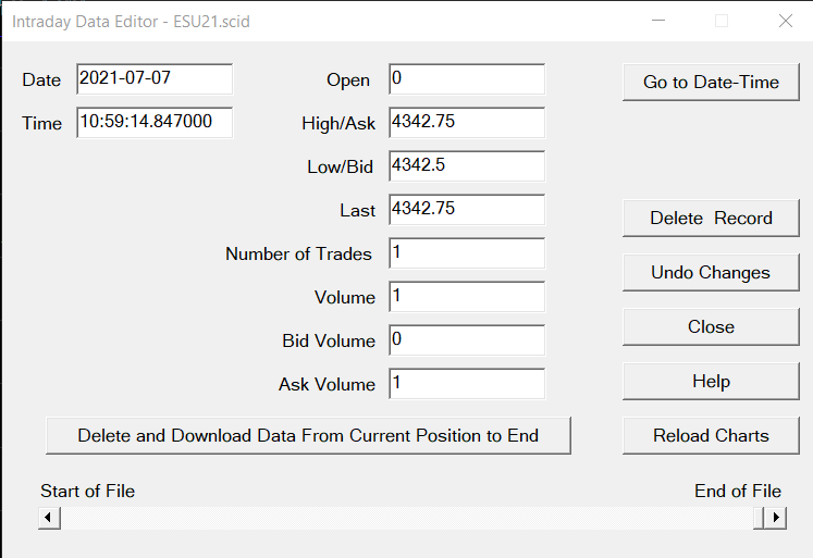

Attached are the replay settings and the last tick of data for the symbol
As you can see:
IsReplayRunning is turned off starting at 10:58. Shouldn't this be set thru the last bar at 10:59?
GetReplayHasFinishedStatus is set at 10:58. Shouldn't this be set at the 10:59 bar?
The last bar of the replay (10:59) is called twice but with both flags cleared. Why is the last bar not included in the replay?

imagereplay.png / V - Attached On 2021-07-07 16:45:01 UTC - Size: 24.89 KB - 379 views
imagelast tick.png / V - Attached On 2021-07-07 16:45:10 UTC - Size: 26.24 KB - 364 views

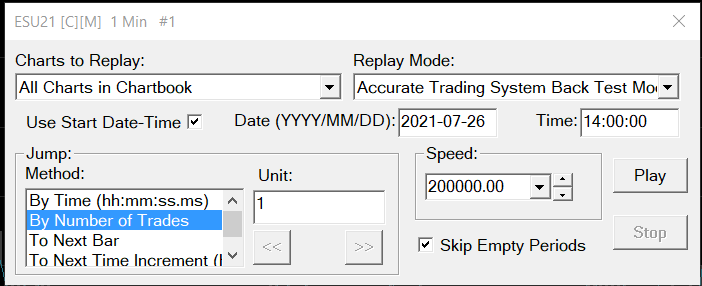

This code run while disconnected with the attached replay settings:

imagereplay-settings.png / V - Attached On 2021-07-26 22:19:32 UTC - Size: 22.54 KB - 338 views
