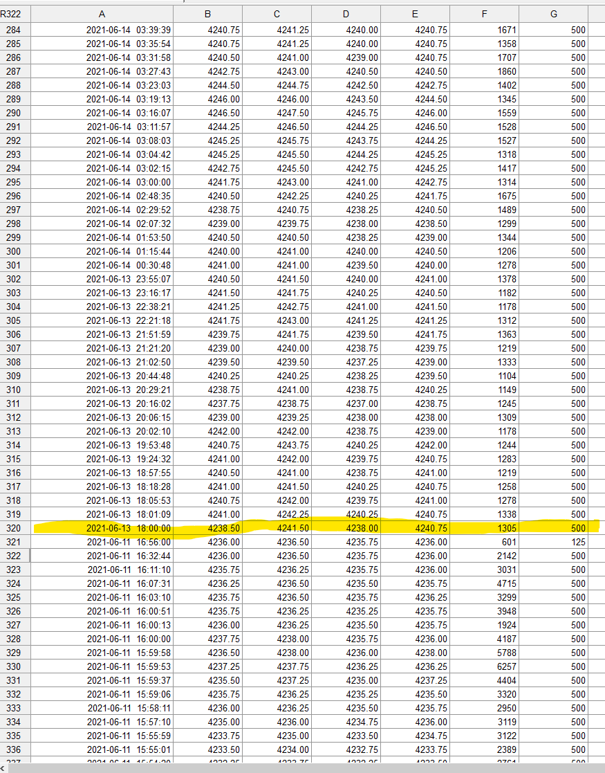

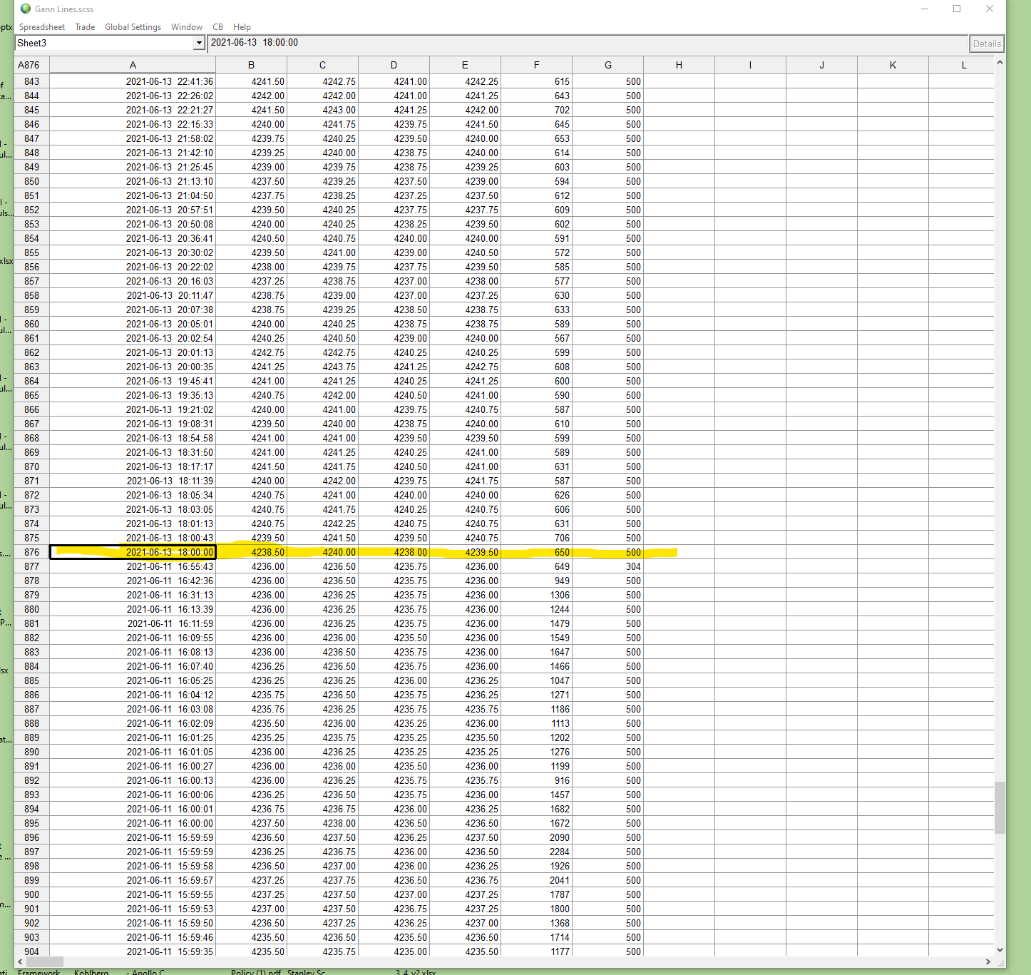

I'm using two chartbooks. Both Chartbooks have the /ES set at 500 ticks. Both chart settings are identical (same start time, end time, aggregation period, etc.). However, it seems that one chartbook is receiving more data/volume than the other, and as a result, the tick charts are not identical.
Where should I look to troubleshoot this?

[2021-06-14 21:03:46]
John - SC Support - Posts: 48091
Refer to the following:

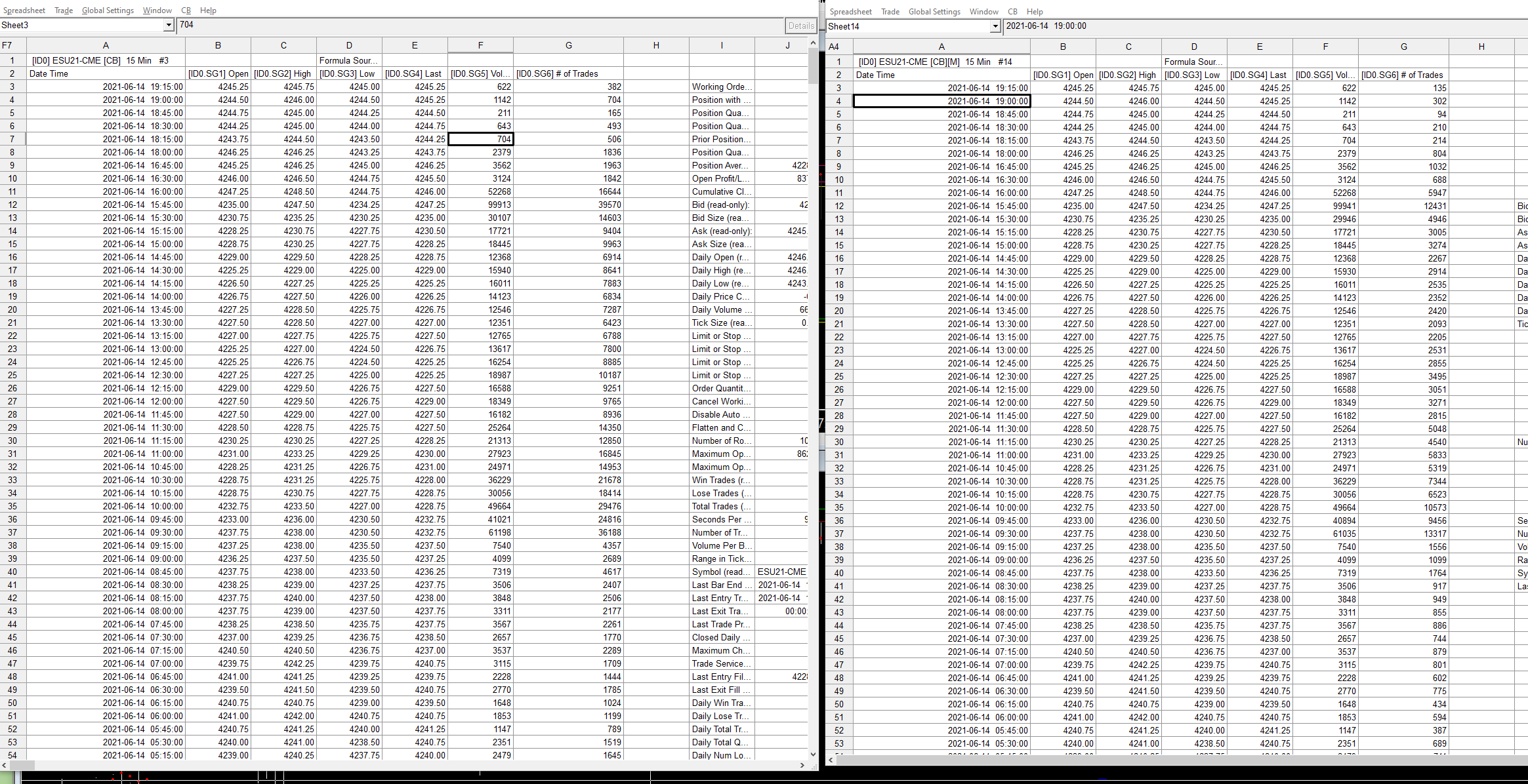

To provide some further detail here:
When switching to the 15Min chart on both chartbooks: volume and price are identical (or close enough); however, tick count differs. Something doesn't seem right? Any suggestions?

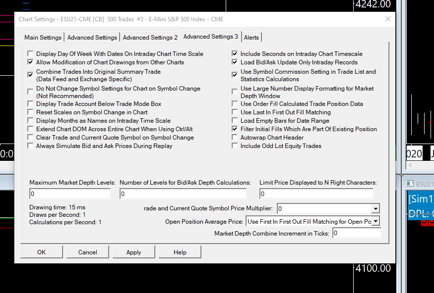

Apologies for the flood of messages. I found the reason for the difference and wanted to post an update.
Under Chart Settings / Advanced Settings 3, one set of charts had "Combine Trades into Originial Summary Trade" activated (check mark). For whatever reason this difference was resulting in a huge discrepancy between the two charts.
