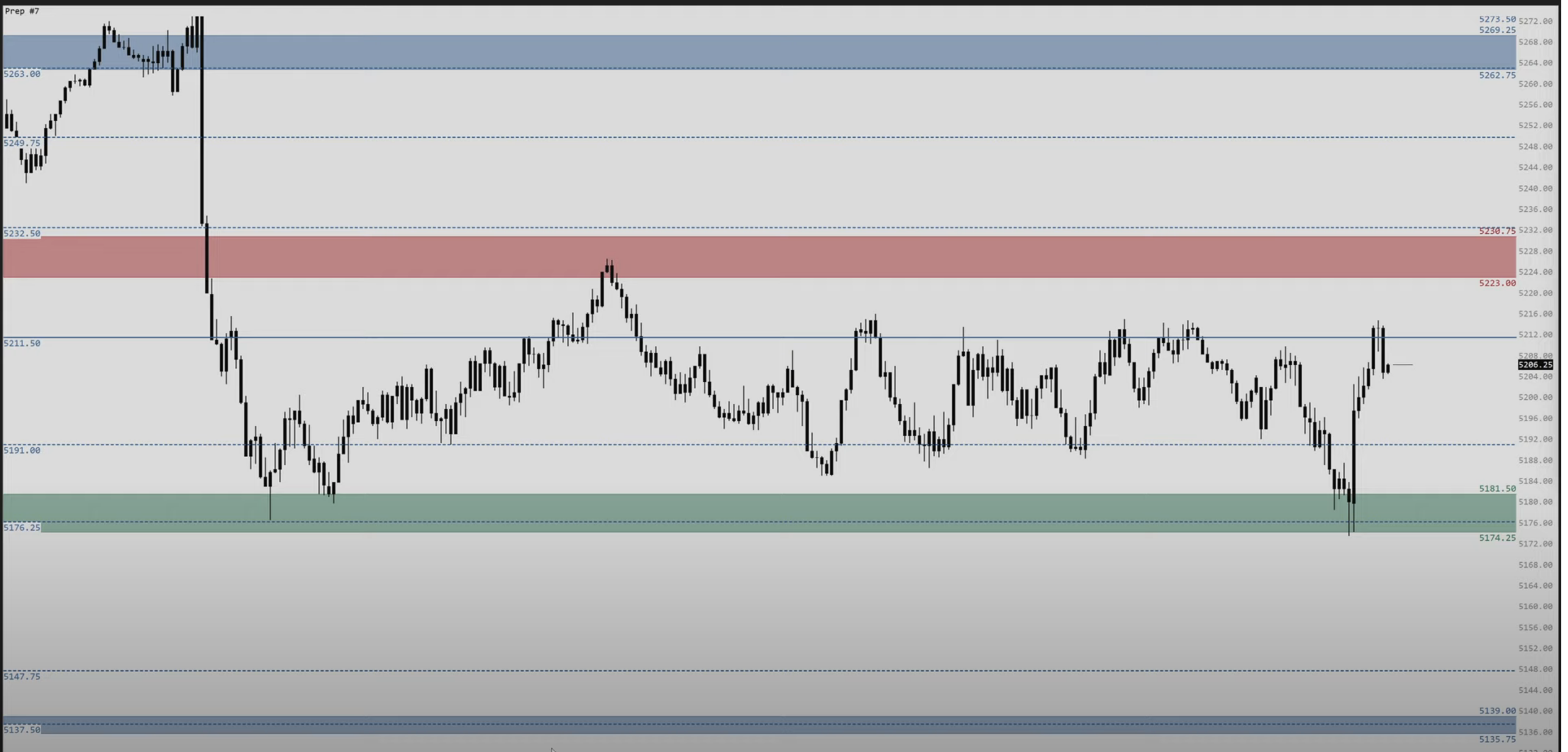

The way I would like to show the labels is shown in the attached file.

[2024-04-12 14:16:29]
The properties window in the image is from an "Extended Line" tool. The Line/Extended Line do not have an option to display a price label. The alignment options that are in the Properties/Configuration window are for when you add text using the "Modify Text" option on the right-click menu for this tool.
The "Horizontal Line" tool, does have the option as we described above. And you can do what you want with the Horizontal Line drawings by aligning the price to the left.
