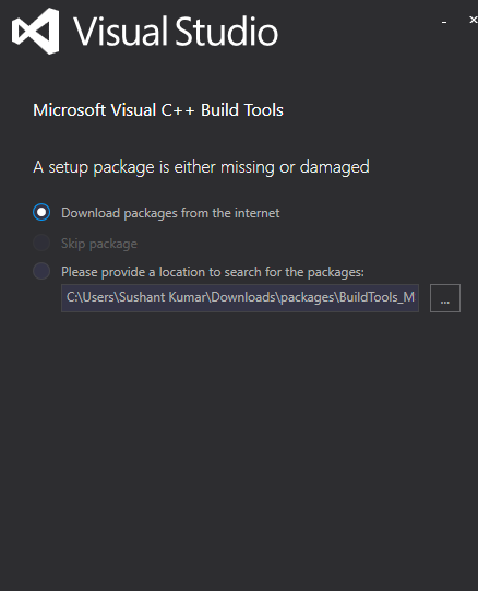

"Install Visual C++ Compiler" downloads microsoft visual c++ build tool but when I click download from internet nothing happens
imageScreenshot 2021-06-02 191044.png / V - Attached On 2021-06-02 13:41:42 UTC - Size: 21.23 KB - 395 views
[2021-06-02 15:42:40]
ForgivingComputers.com - Posts: 1253
You didn't answer the question.
Did you run "Install Visual C++ Compiler" before or after installing Visual Studio? If you did it after you need to uninstall Visual Studio, then Install Visual C++ compiler, then reinstall Visual Studio.

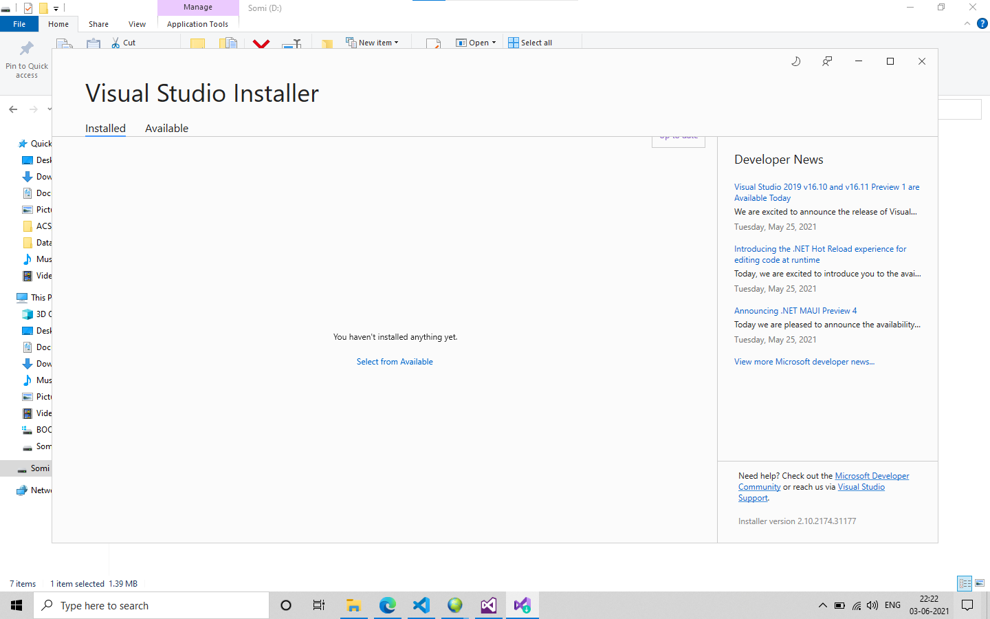

I don't remember if I ran it before installing visual studio or not so I uninstalled the visual studio and again ran the Visual C++ compiler but still it doesn't installs
imageScreenshot 2021-06-03 222243.png / V - Attached On 2021-06-03 16:54:19 UTC - Size: 109.42 KB - 445 views
