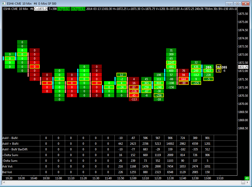

Do they provide backfill data tick by tick? It seems they don't
How can I get tick by tick data?
from your website:
"...Sierra Chart fully supports the Rithmic trading platform service. Rithmic provides low latency trading and market data. With this trading and data service you have access to real-time data, historical data and trading in the futures, stock and currency markets from many exchanges around the world. The Sierra Chart trading features fully support the Rithmic trading platform service. You are able to enter simple and advanced orders from the charts, ChartDOM, Trading DOM and Trade Window all within Sierra Chart.
Rithmic is an excellent backend trading platform service providing tick by tick data and reliable trading services."
Date Time Of Last Edit: 2014-03-13 13:05:38
imageRithmic Number Bars.png / V - Attached On 2014-03-13 13:02:53 UTC - Size: 54.82 KB - 1885 views

When using Rithmic you will not get historical tick by tick data. You will need to use the Sierra Chart market data feed for this:
https://www.sierrachart.com/index.php?l=doc/SierraChartRealTimeFuturesStockDataFeed.php
