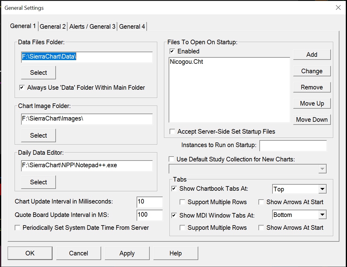

Nicogou21 - Posts: 12
I have added the CME Bundle to the existing Eurex....
I noticed as well that with the Dax, the same thing happens....
And when I try to change the settings, it does not do anything....
I even tried to change the Chart Update Interval in Milliseconds to 5, but it does not save it
imageSet Up Chart Interval.PNG / V - Attached On 2021-05-27 07:27:31 UTC - Size: 58.51 KB - 292 views
[2021-05-27 13:39:30]
John - SC Support - Posts: 48456
The lowest you can set the Chart Update Interval is 10, which is why it changes to that value when you try to set something less than that.
