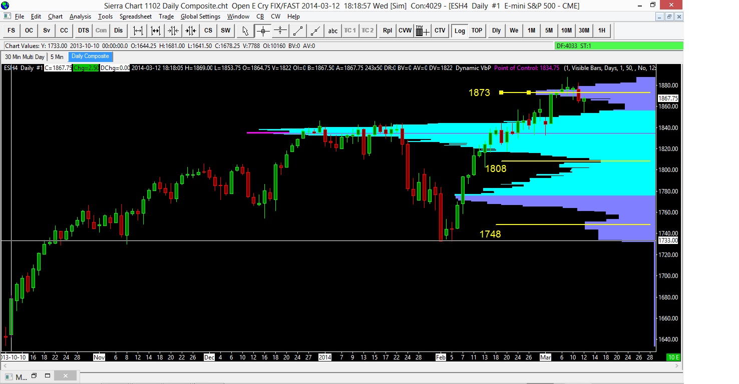

Hello. I am new to your application and have developed a chart using your Volume By Price Study guide to add the study. However, I want to go back to Oct-9-2013 and no matter what I do the study doesn't seem to consider all the data from that date to present.
Is there something I'm missing?

What is the symbol of the chart? And when you scroll back to the very first bar, what is the date that bar?

I have attached a screenshot for your reference. The date of the very first bar is Oct 9, 2013. It seems as though the study stops including data below the 1733 price.
Your thoughts?

We see what you are describing. The solution is to set that chart as a Continuous Futures Contract chart:
https://www.sierrachart.com/index.php?l=doc/doc_ContinuousFuturesContractCharts.html
