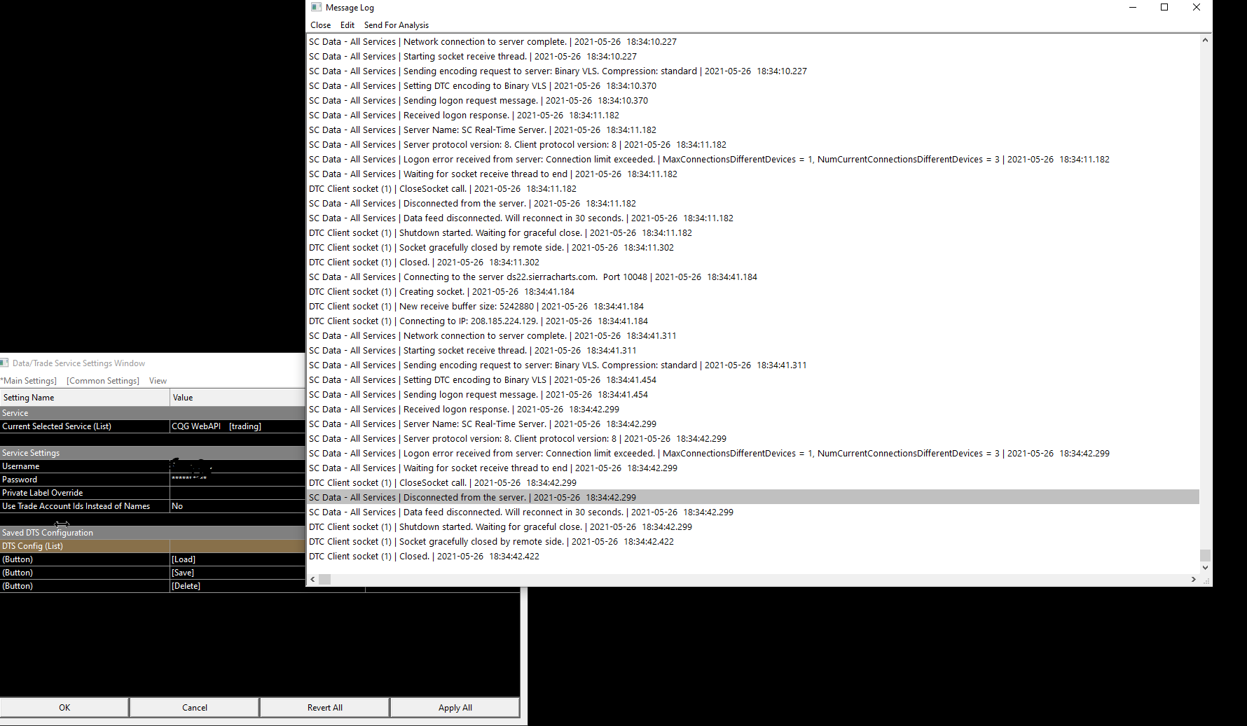

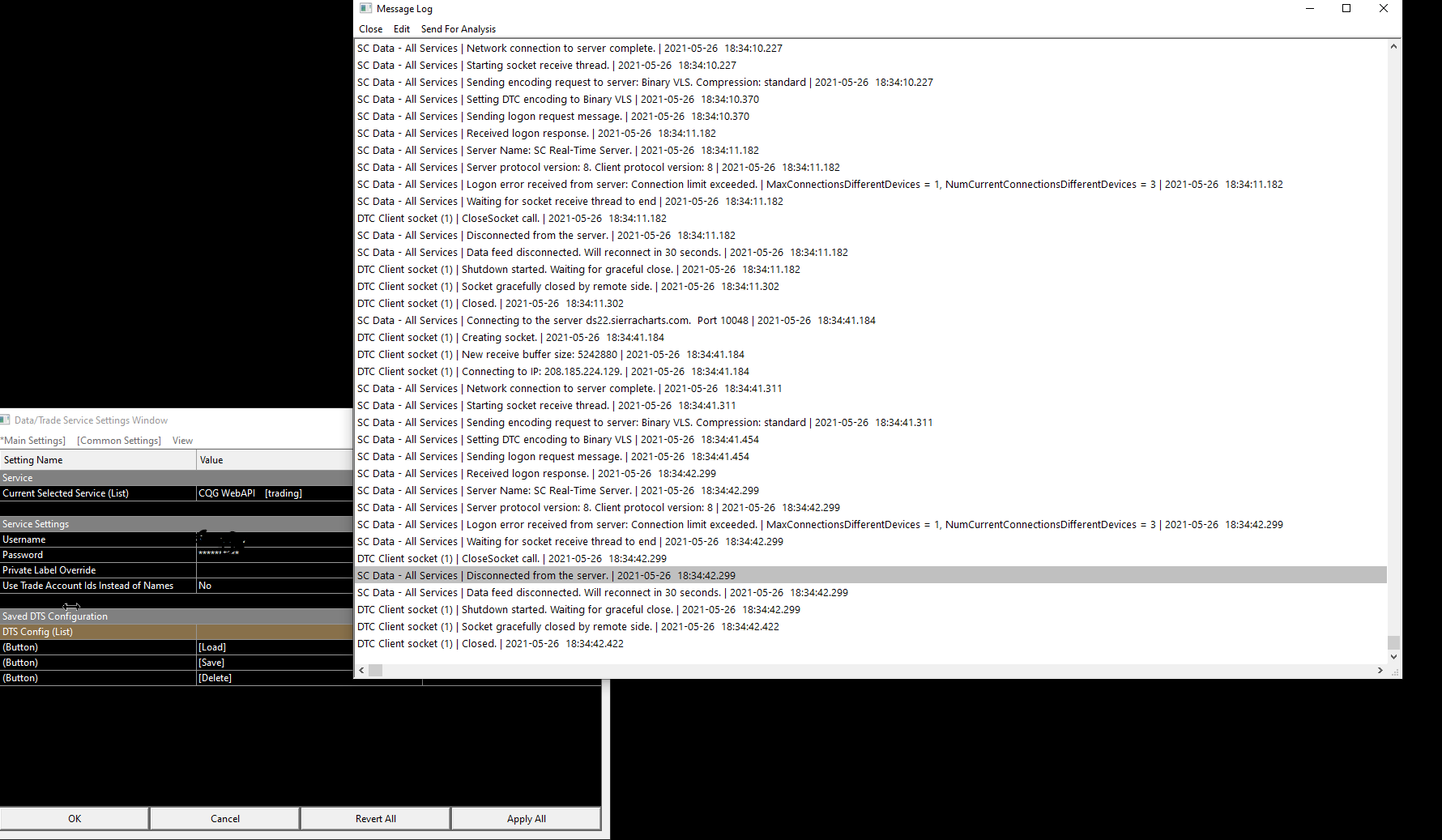

I did exactly how you said.
Now I run Sierra only on two PC with two different data feed, but I still reieve this message log on the my second connection, even when data feed is different.
What can be the problem?

[2021-05-26 18:05:04]
Your Sierra Chart account which you have logged into this Support Board with is expired. So we know what Sierra Chart account you are using, go to Help >> Support Board from within the Sierra Chart desktop program and then post in this thread telling us this is done.
Or, if this is the account you are trying to use, then the problem is that your account is expired and you need to add Usage Time.
