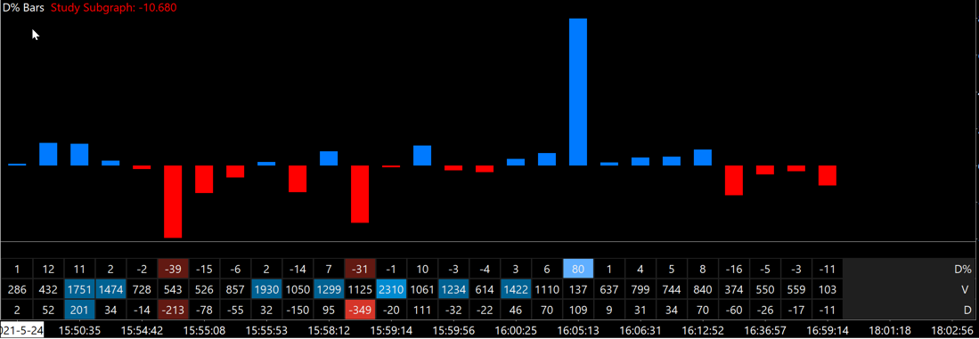

OK, thx for the info. Here's basically what I want, but instead of the red bars going down, I want all the bars going up...
image2021-05-24_17-03-49.png / V - Attached On 2021-05-24 21:04:56 UTC - Size: 78.03 KB - 569 views
[2021-05-24 21:09:00]
John - SC Support - Posts: 48547
Start by doing Step #1 that we gave you above. If the coloring changes, then you will need to go to Step #2.
[2021-05-24 21:22:48]
jaxscott - Posts: 58
I did the spreadsheet study, and that put the bars in the correct orientation. Simply switch Auto-Coloring to "Same as Base Graph" actually did the trick. Thx
