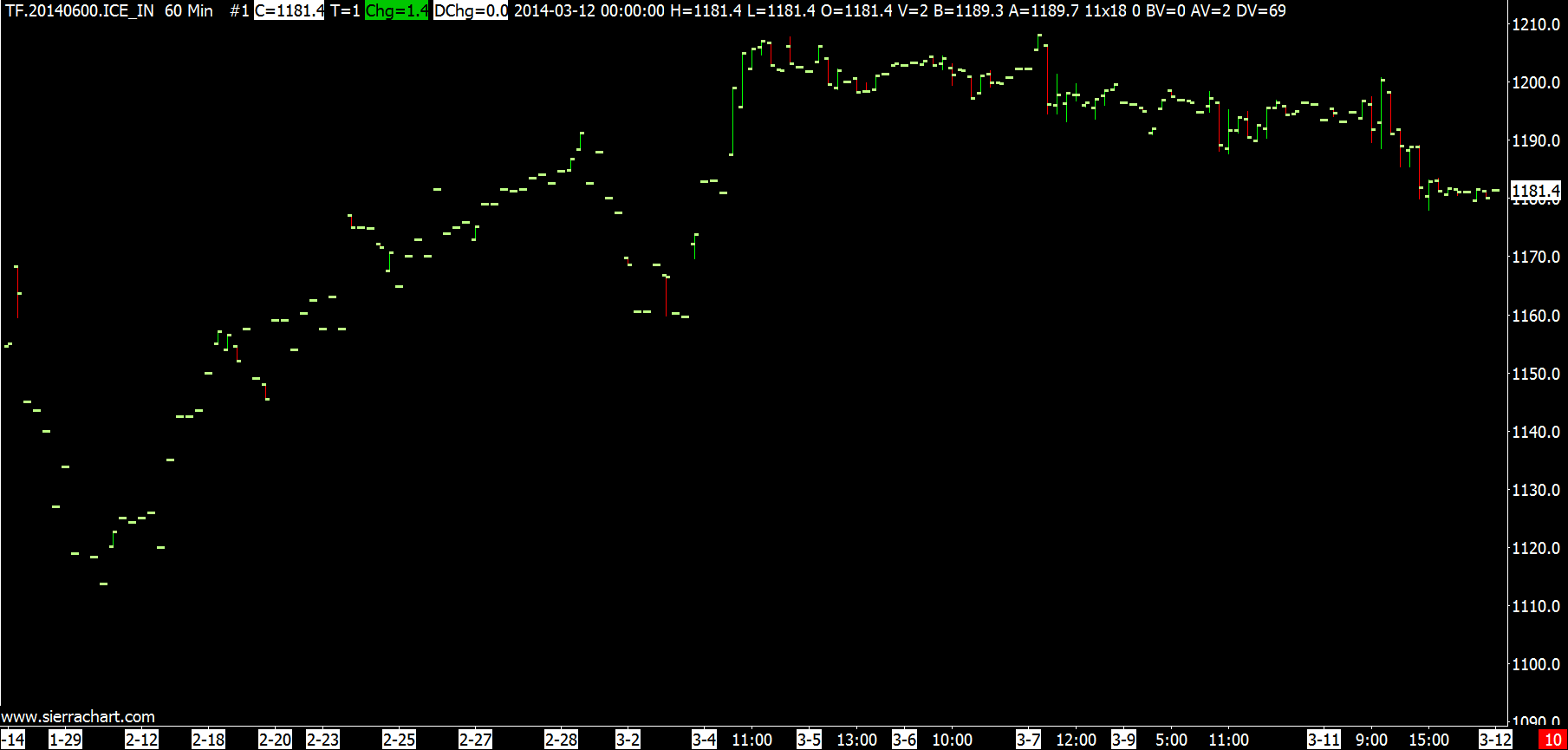

No open expired contracts. The TF and DX both were opened by themselves no chartbook and no other contracts. I'm opening these 2 contracts new after deleting all data files for them. This is for the June contracts.
They don take long to load The data on the TF is not complete. It does go back into December but it's not showing every trading day. It skips all around. For example goes from 02/03t/14 to 02/11/14.
[2014-03-13 08:06:57]
Yes, this actually makes sense. We see this as well:
http://www.sierrachart.com/image.php?l=1394697965878.png
This particular futures contract was not the active contract during that point in time. In any case this is something we would not have control over.

arrow - Posts: 52
I seem to remember before using continuous charts this is how the data was for these charts.
The front month had little data while the next contract out had even less.
Using continuous charts fixed all that.
Explains why the charts look like this again.
