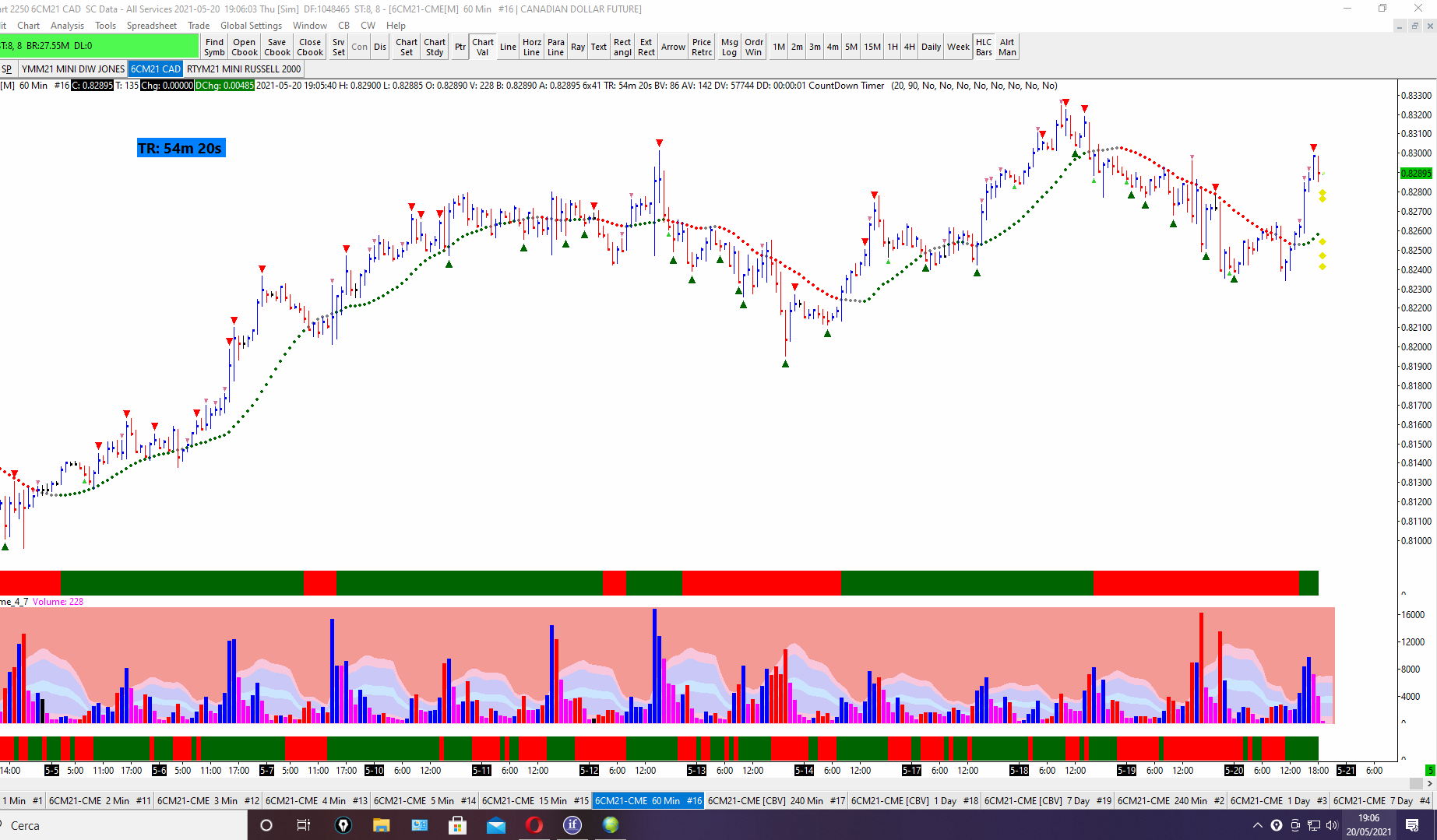

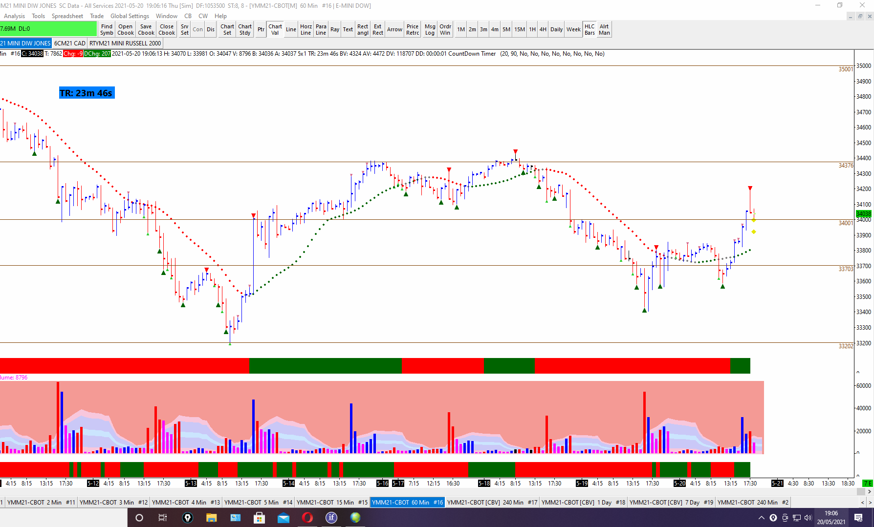

I opened 2 different instruments and i opened a 1 hour chart, but the problem is that i see different different countdowntimer in the 2 charts ( as in the pictures)
For currencies it seems ok, but for indices and some instruments i receive different time.
I have my time on Rome time and i set the same time for SierraChart and in the charts too.
Thank you very much
Best regards

That is just due to the Session Times. The bars are going to start at the time established by the Start Time in the Session Times. In your case, you have the RTY set to start at the half-hour mark and the 6C is set to start at the hour mark. Refer to the following:
Chart Session Times: Bar Starting Times
