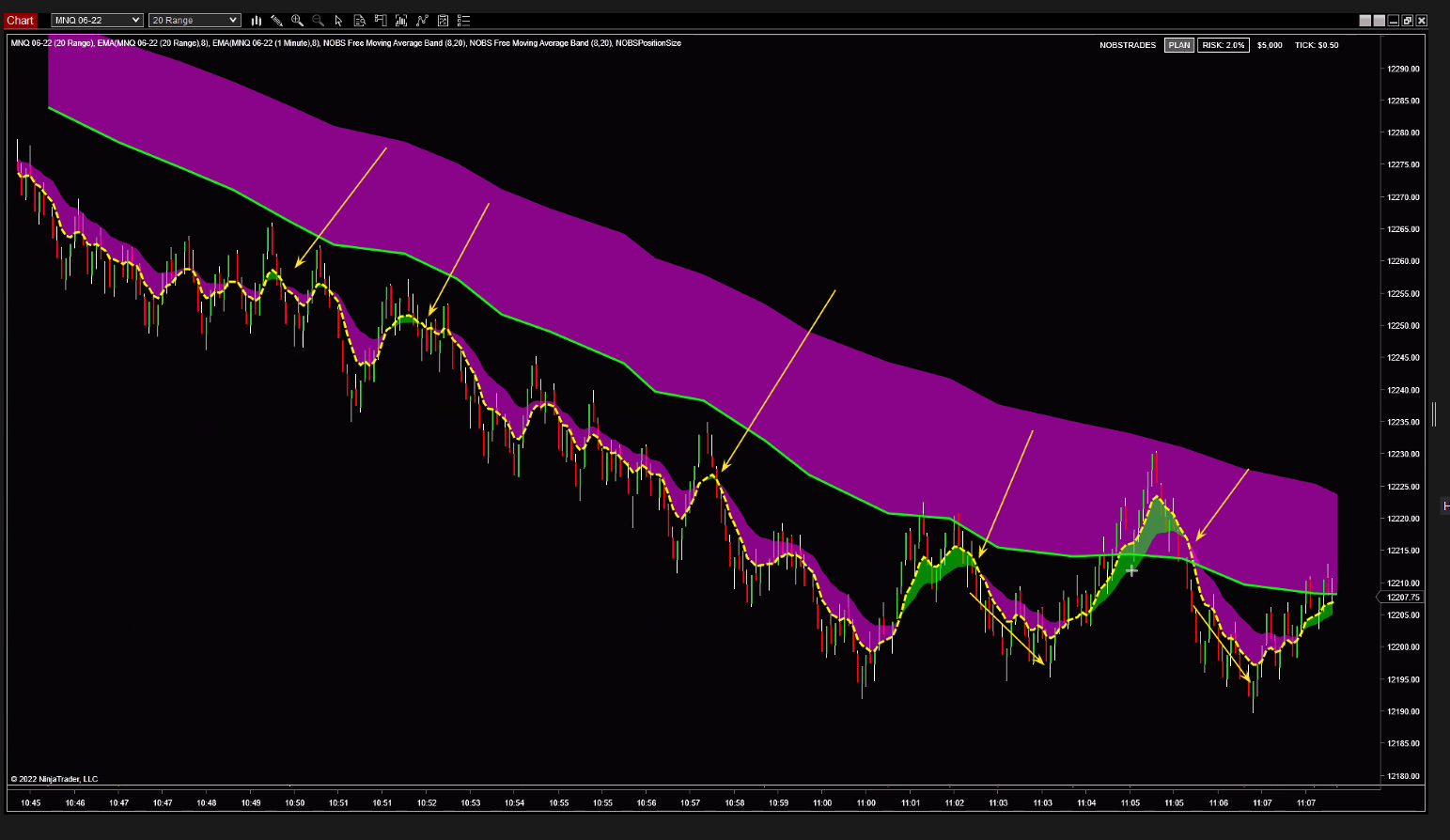

How do i get the ema 10 & 20, and 50 & 100 to create a shadow in between the emas? Blue when going up and maroon when going down. Like the attached photo.

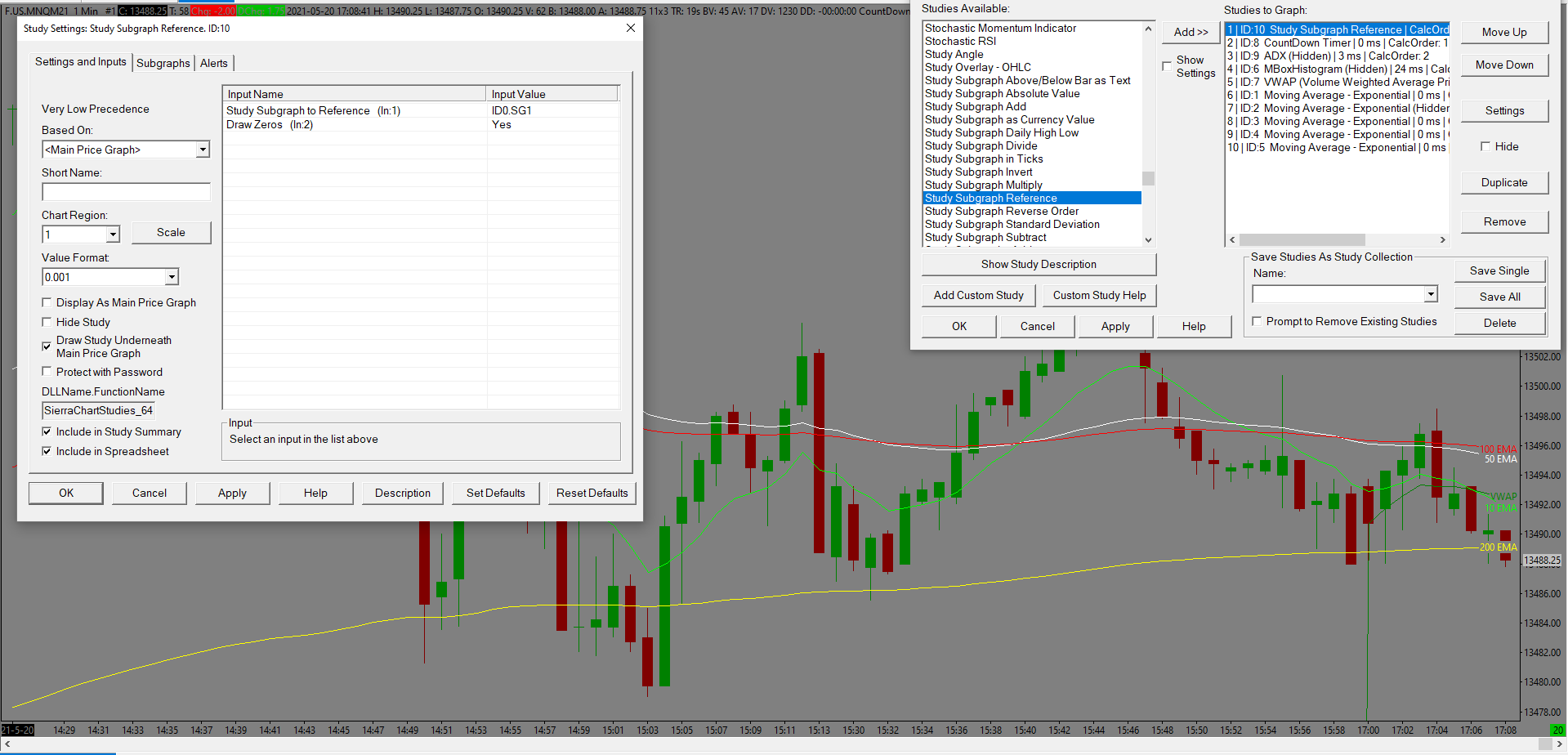

In the attached pics, I've completed Line 7.
Where/what is the Input Study 1 & Input Study 2?
imageCapture121.PNG / V - Attached On 2021-05-20 22:09:50 UTC - Size: 132.88 KB - 441 views
imageCapture122.PNG / V - Attached On 2021-05-20 22:10:53 UTC - Size: 57.21 KB - 446 views
[2021-05-24 14:04:37]
You have to be careful. There are two different studies, one called Study Subgraph Reference and the other called Study Subgraphs Reference, note the 's' at the end of Subgraphs in the second one. It is the second one that you need Study Subgraphs Reference, that will give you the two inputs you need.

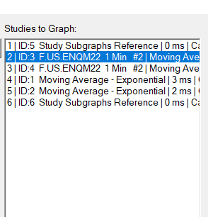

I got it to semi work the shadow is displaying as a clone, away from the Green/Blue EMA, I want the shadow in between them to
imageCaptureCL.PNG / V - Attached On 2021-05-27 15:20:09 UTC - Size: 115.01 KB - 369 views
[2021-05-28 13:12:54]
Change the Scale for the Study Subgraphs Reference to "Automatic". Refer to the following:

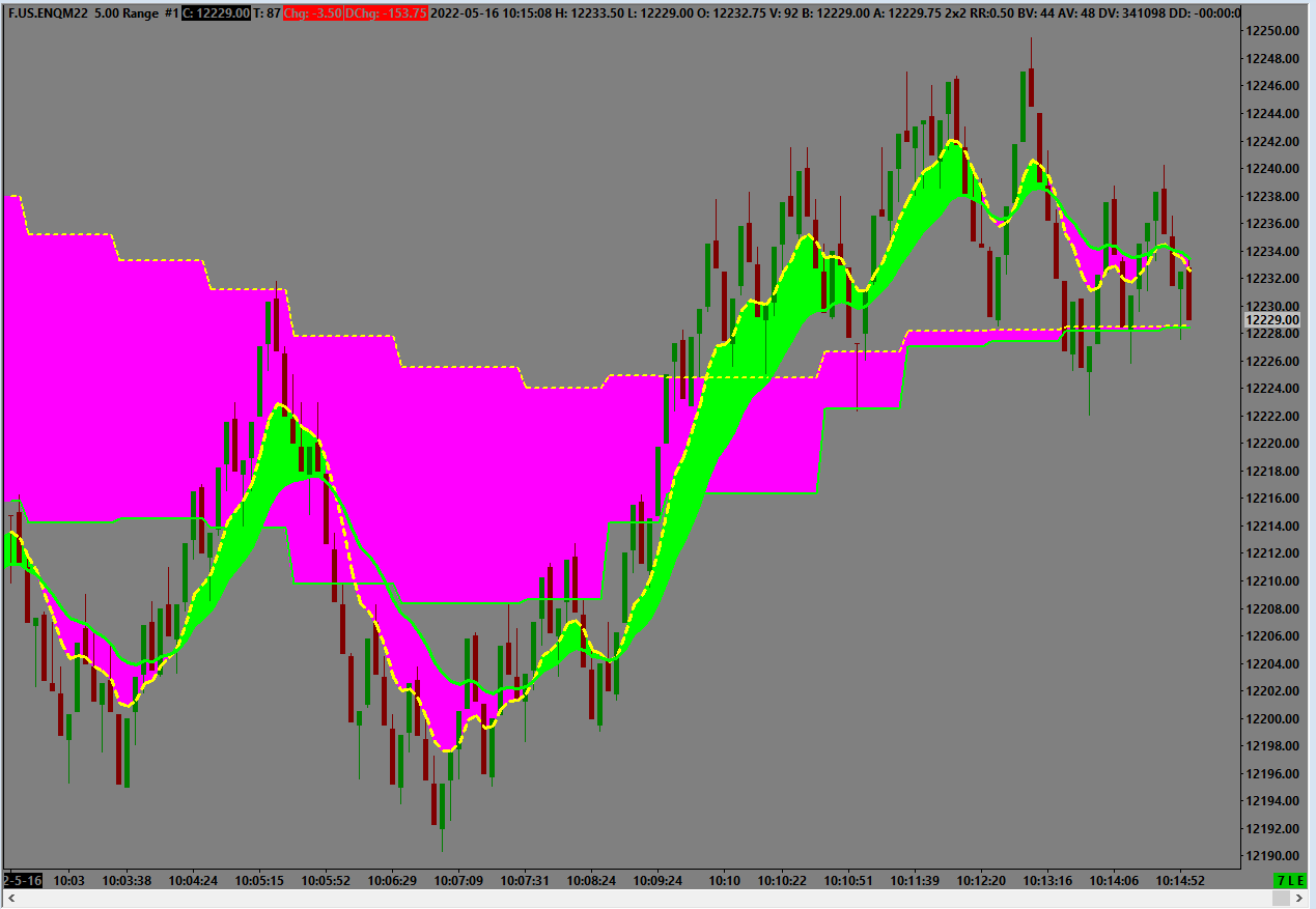

Im trying to get my Sierra Chart(Gray background) to look like the NT8 chart(Black background), I'm trying to have the lines be smooth not like the stairway like it is, the draw style is solid line but it is still showing the stairway
imagehelp.PNG / V - Attached On 2022-05-16 15:14:59 UTC - Size: 298.03 KB - 338 views
imagehelp2.PNG / V - Attached On 2022-05-16 15:15:28 UTC - Size: 72.82 KB - 336 views
[2022-05-16 17:34:50]
What study is producing that stair-step line and what is the subgraph Draw Style set to for it? If it is set to Dash then change it to Line and see if that resolves your issue. Refer to the following regarding Draw Styles:
Chart Studies: Subgraphs Tab >> Draw Style
