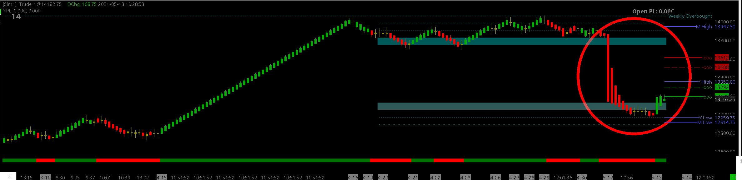

Good afternoon,
I am having issues with what seems to be related to data feed since I started to get the Equity feed from SC. Candles on NQ completely wrong plus not updating.
Can you please take a look at the pictures attached, so I may find a solution.
I attached pictures not screen/image as suggested in your protocol to send links from SC platform because the error message disappears quickly.
Regards
Eliseo

[2021-05-13 16:33:01]
John - SC Support - Posts: 48353
What you are seeing are issues related to the CQG data. It is odd timing, but it does not have anything to do with having enabled the U.S. Equities data.
You really need to use the Denali Exchange Data Feed for your CME Group data. Refer to the information on the following page, including Setup Instructions:

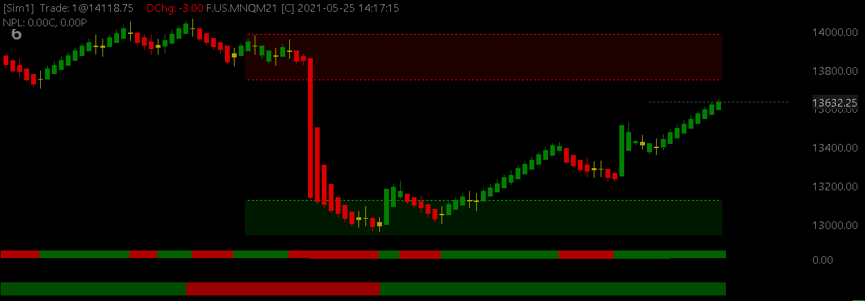

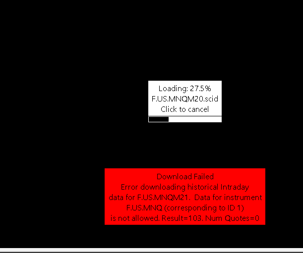

I signed up for Denali, but I continue to have problems with data feed:
http://www.sierrachart.com/image.php?Image=1621966639175.png
I already have data for stocks and just trying to get the basic Denali for CME Nasdaq futures with no market deep.
I connect via CQG WebAPI (trading) and my broker is WHSelf Invest.
Please tell me what I need to do to be finally be able to trade again Nasdaq futures.
Thank You
Regards
Eliseo
[2021-05-25 18:59:17]
You need to follow the Setup Instructions starting here:
Denali Exchange Data Feed: Sign the Agreements: The CME Group (Denali Exchange Data Feed Setup Instructions)
Be sure you go through all the rest of the Setup Instructions for the CME Group, which will include activating an exchange and final setup.
Since you are wanting data for the NAS without Market Depth, you could activate the CME non-professional top-of-book exchange for just $1.25 per month.
