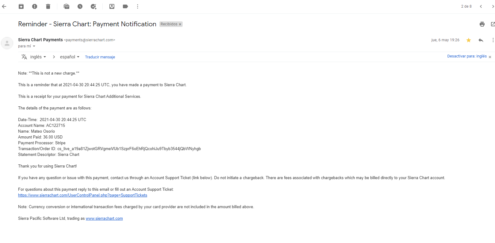

User751124 - Posts: 3
Hola!
Los datos que necesito intercambiar son futuros del SP500 y NASDAQ con el paquete de level 5
En abril realice el pago para obtener los datos porque entendi que no los descontarian del balance de la cuenta
Pero a pesar del pago de 36USD para el paquete 5 no recibi datos durante todo el mes
Gracias por la ayuda
Adjunto correo donde se evidencia el pago
imagePAGOSIERRA.PNG / V - Attached On 2021-05-25 20:04:31 UTC - Size: 62.27 KB - 280 views

John - SC Support - Posts: 48363
From Google Translate:
Hi!
The data I need to trade is SP500 and NASDAQ futures with the level 5 package
In April I made the payment to obtain the data because I understood that they would not deduct them from the account balance
But despite paying 36USD for package 5 I did not receive data for the whole month
Thanks for the help
I attach email where the payment is evidenced
Package 5 only includes the Real-Time data as we have pointed out above, for Forex and CFDs. In order to get the Real-Time data for the S&P 500 and NASDAQ Futures, you would have to use the Denali Exchange Data Feed and pay for the Real-Time data.
The $36.00 you paid was for the Sierra Chart Package 5 for one month. That is just to be able to use the software. Again, the real-time data for the CME Group (which is where the futures data you are wanting is from) costs extra.
In order to get the Real-Time data for the CME Group, follow these instructions:
Note that you will get the remainder of the month in which you first activate an exchange for free, which means that if you activate it today, you would get the remainder of May for free and then pay the full exchange fee on June 1. So you may want to wait until June 1 to activate the exchange in order to save some money.
