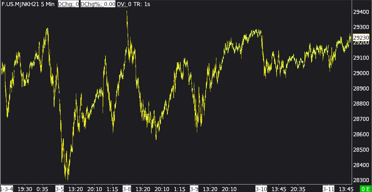

When I view the data using 5 minutes per bar (RTH or ETH), it looks great (see attachment).

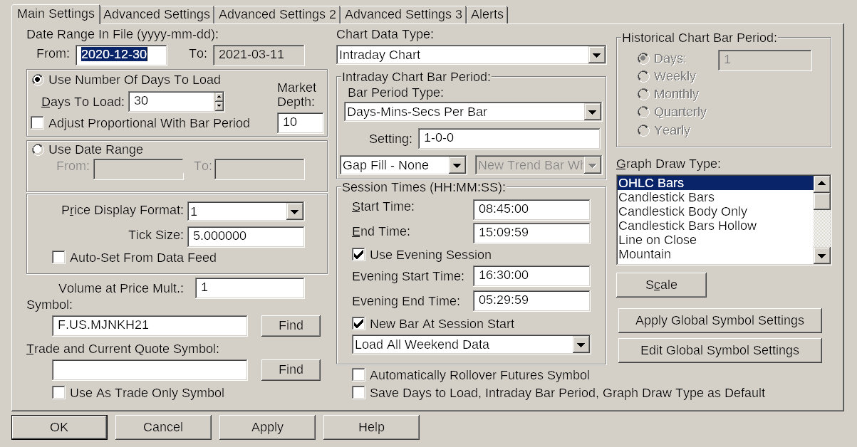

Because I couldn't attach an additional file, here are the settings for the chart (attached).
