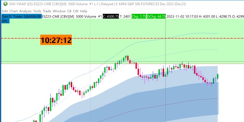

[2023-11-02 14:29:54]
Gsleeve1 - Posts: 5
That doesn't change anything. See the attached screenshot please and advise on how to get the green/up bars to have green wicks and borders.

[2023-11-02 14:55:46]
John - SC Support - Posts: 48438

[2023-11-02 15:35:12]
You have a Hekin-Ashi study that is drawing those lines in that particular coloring. You also have the Heikin-Ashi set to only be HL Bars, which if that is what you want, then that is fine, but you will need to determine the colors in the Subgraphs for the High and Low as you want them for the Heikin-Ashi study.

Gsleeve1 - Posts: 5
That must have come over from the chart I copied and tried to change. I've looked in the obvious places, but no luck - where do I find those settings?
[2023-11-02 19:09:06]
The easy solution is to remove the Heikin-Ashi if you do not want it, that will remove those wicks.
Otherwise, it is the color of the subgraphs for the Heikin-Ashi study that needs to be changed (specifically the High and Low). Refer to the following:
Chart Studies: Subgraphs Tab >> Color
