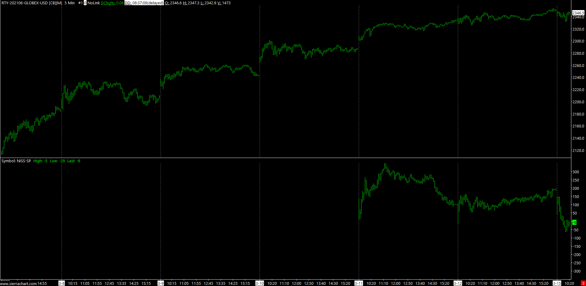

I have been using an intraday chart with ES and NISS-SP added as an additional symbol for quite some time now. I use one year worth of data so I can backtest ideas over a 12+ month period. Today, out of nothing, NISS-SP only shows one month of data. I have tried using different symbols (on both regions, e.g., RTY & NISS-TF): same limitation. I created a new chart in a new chartbook to try to identify the issue but the new chart, built from scratch, also has one month data. A second SC instance that has the same configuration shows the complete 12 month horizon for NISS-SP.

Open a separate chart for NISS-SP and then set the Days to Load in Chart >> Chart Settings to 365 and do you see one year of data for that symbol?

yes
[2021-04-13 14:51:26]
Kutya - Posts: 17
separate chart for NISS-SP shows the whole year. upgraded to ver 2248. stillone month of data for the added symbol.

We need to get that chart that has an issue, by following these instructions and we will test:
[2021-04-14 05:04:01]
Kutya - Posts: 17
Attached; here's the image: http://www.sierrachart.com/image.php?Image=1618376380683.png

We are testing this now.
[2021-04-21 05:21:43]
We have identified the issue. It is fairly complex of a problem/solution but we will work on a solution.

We handled the other issue as fast as we can. This is quite involved to be looking into an issue like this. And furthermore, the reason for the issue is because the chart is a continuous futures chart and the limited data was just following the first date of the most recent contract.
