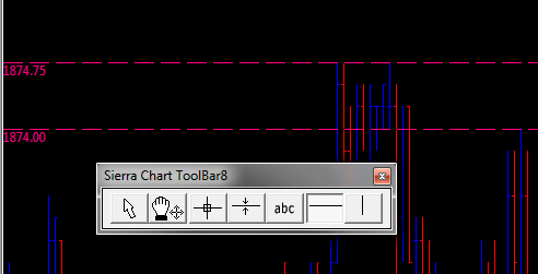

I am setting up a personal toolbar (application areas of support / resistance).
In the toolbar button added horizontal lines.
Questions:
How to create (paint) the area between the two horizontal lines?
How do I put on the back burner area (chart above)?
How to create buttons for different areas of support / resistance?
Date Time Of Last Edit: 2014-03-06 04:49:30
image12.png / V - Attached On 2014-03-06 04:49:07 UTC - Size: 10.48 KB - 579 views
[2014-03-06 17:39:14]
Have a look at using the Rectangle or Extending Rectangle tools:
http://www.sierrachart.com/index.php?l=doc/doc_Tools.html#RectangleEllipseTools
