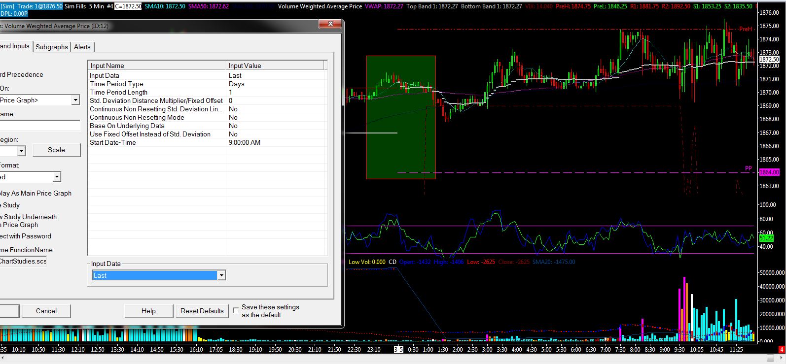

I'm having problems with the Volume Weighted Average tool.
I changed the start time in the tool's menu, but the start time does not change in the chart (it remains starting at 00:00).
Any ideas what he problem may be?
I tested this on 1min and 5min charts with VWAP set for 1 day (default setting). I also forced a chart refresh to try to get it sorted, but no luck.
Noticed the following thread covering the VWAP start time subject: https://www.sierrachart.com/supportboard/showthread.php?t=42239&highlight=vwap. Could not figure how to make a reply on the thread. My apologies for that.
Screenshot attached.
Many thanks
imagescreensh.JPG / V - Attached On 2014-03-05 21:39:47 UTC - Size: 205.92 KB - 559 views

You need to set the Session Times within Chart Settings:
http://www.sierrachart.com/index.php?l=doc/doc_ChartSettings.html#SessionTimes
[2014-03-19 17:32:59]
User99689 - Posts: 27
Yes it right but how then using 2 vwap for us and europeen sessions for ex in the same chart ?
[2014-03-19 17:54:05]
You cannot.
[2014-03-19 18:43:37]
NRGTrader - Posts: 351
Use overlay study on your main chart from vwap study on a chart using the second time frame, e.g., European session.
[2014-03-19 20:39:07]
As has been said in the prior post, you could set up another Volume Weighted Average Price study as you require on another chart and overlay it to a different chart.
Refer to this help topic:
http://www.sierrachart.com/index.php?l=doc/helpdetails28.html
