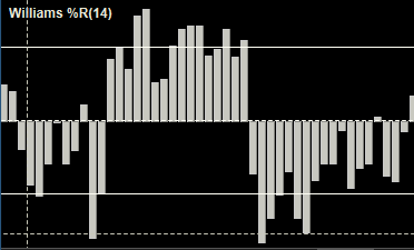

We would like to display the William's %R indicator as a histogram instead of a line, above/below the -50 line. Attached is a picture for reference.
Please advise of a workaround for this.
Thank you.

In general, you would set the Draw Style for the subgraph to Bar. But, this is only going to give you up/down bars based on positive/negative values. There is no way to specify that you want the up/down to occur at a different level.
A workaround, but not perfect, would be to use the Study Subgraph Add study and add 50 to the data to move the -50 essentially up to 0. It would then look like you want, but the actual values would not be correct.
