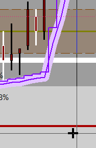

[2022-02-16 01:46:37]
whats1thingnow - Posts: 418
please see the gif
1) i draw a trend line
2) i click to edit the horizontal extending rectangle
3) i change my mind and i right click to "cancel" editing horizontal extending rectangle
after right click, it does UNDO for previous drawing (in this case, deletes the trendline i drew)
imageright_click_undos_last_drawing.gif / V - Attached On 2022-02-16 01:44:51 UTC - Size: 61.24 KB - 399 views

[2022-02-18 22:34:19]
i think i found out how to reproduce it:
1) draw a trend line
2) click to edit the horizontal extending rectangle (this is chart drawing copied from another chart)
3) i change my mind and i right click to "cancel" editing horizontal extending rectangle = after right click, it does UNDO for previous drawing (in this case, deletes the trendline i drew)
vs another scenario:
2) i click to edit the horizontal extending rectangle (this drawing is NOT copied from another chart)
3) i change my mind and i right click to "cancel" editing horizontal extending rectangle = after right click, extending rectangle goes back to same place, trend line stays
so...
that means this behavior is showing up only in scenario 1, when i try to edit a drawing THAT IS COPIED FROM ANOTHER CHART, but change my mind and do the right click
please see if you can reproduce it now
thanks
