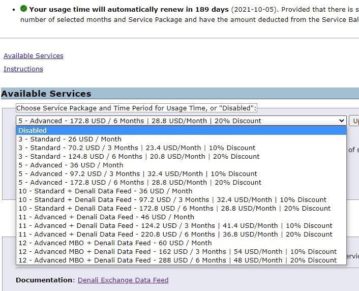

User164231 - Posts: 281
so for 1 month trial I have to accept the Advanced + Denali Data Feed = $46, even though I still have 188 days of Advanced package left?
How do I convert my balance days to Advanced + Denali Data Feed?
[2021-03-31 13:22:30]
You can freely change between the different service packages at any time. So you can use the Denali data feed for a week and only pay for the cost for a week.
There is no trial other than potentially with the exchange fee.
To change your Sierra Chart Service Package, select "Help >> Account Control Panel" on the Sierra Chart program menu. On the displayed webpage, click on the "Set Service Package for Renewal" link.
Or go to this page:
https://www.sierrachart.com/UserControlPanel.php?page=ServicesActivation
You will need to login if you are not currently logged in.
In the "Available Services >> Choose Usage Time Service Package" frame, select the Service Package that you want to set your account to. Press the "Set" button.
The remaining service usage time on your account will be adjusted based upon the cost of the package you are changing to. If the new package is a higher-priced package, then the usage time will be reduced due to the higher price.
There is no charge for changing your Sierra Chart service package. Only your Sierra Chart account usage time ending date is adjusted.
Date Time Of Last Edit: 2021-03-31 13:23:00

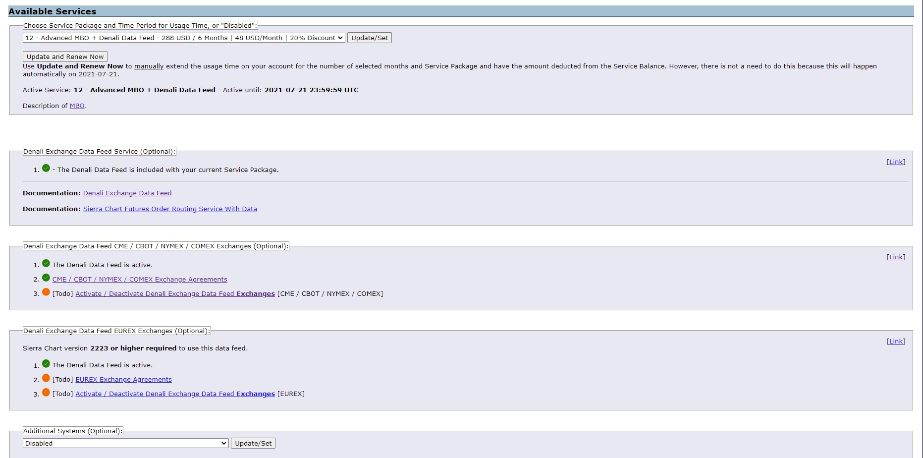

https://www.sierrachart.com/UserControlPanel.php?page=ServicesActivation#DenaliCME
what else do I need to activate if I choose 12 for 6 months?
Date Time Of Last Edit: 2021-04-01 13:30:38
imageUntitled.jpg / V - Attached On 2021-04-01 12:13:39 UTC - Size: 253.1 KB - 398 views
[2021-04-01 14:44:22]
We are not sure exactly what you are asking.
When you selected Package 12, you Usage Time End Date changed, as described above.
With regards to the Denali Exchange Data Feed, you need to finish the Setup Instructions starting here:
Denali Exchange Data Feed: Activate the Exchanges: The CME Group (Denali Exchange Data Feed Setup Instructions)
[2021-04-01 16:17:21]
I see, you mean I need to activate item 3 of attached?
What happened to my existing unused credit? Possible to calculate the credit balance and just pay up the difference if I upgrade?
imageUntitled.jpg / V - Attached On 2021-04-01 16:13:07 UTC - Size: 43.02 KB - 354 views
[2021-04-01 18:23:04]
Yes. Go there and activate an exchange. Also go through the remaining items in the Setup Instructions to make sure you have everything setup correctly.
We do not have a method to pay for the difference in the packages, we just change the end date.

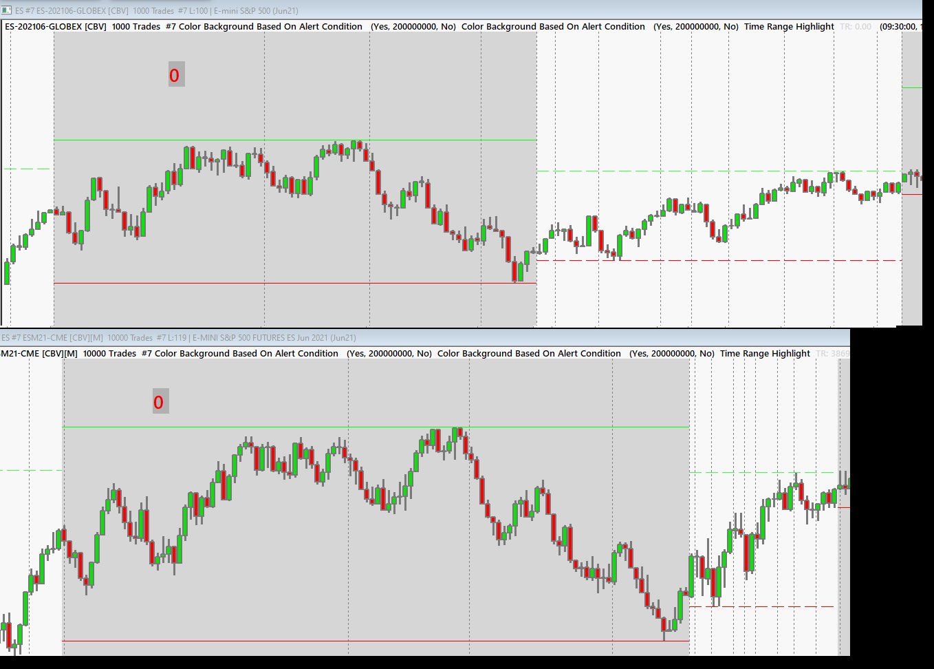

Managed to download ES historical "Numbers of trades per bar" using Denali Datafeed.
I notice 2 oddities;
1. With IB, the Globex session has little volume but more candles. With Denali, the volume per bar is similar be it Globex or Pit session. I am wondering if Denali is reconstructing historical tick chart using VOLUME instead of # of TRADE?
2. With IB I set ES to 1000 tick. For Denali 10000 tick still produces too many bars (see attached).
Please advise.
imageIB vs Denali Tick Chart.jpg / V - Attached On 2021-04-06 13:49:04 UTC - Size: 249.79 KB - 393 views
[2021-04-06 15:17:26]
Check the bars to ensure that they are showing 10000 trades per bar using the Chart Values/Crosshair tool with the Tool Values Window.
If they are 10000 trades per bar, then that is all there is to it.
[2021-04-06 15:41:11]
the numbers are on the picture.
[2021-04-06 16:03:20]
That is the setting for the chart. Make sure that each bar actually has the proper number in it.
