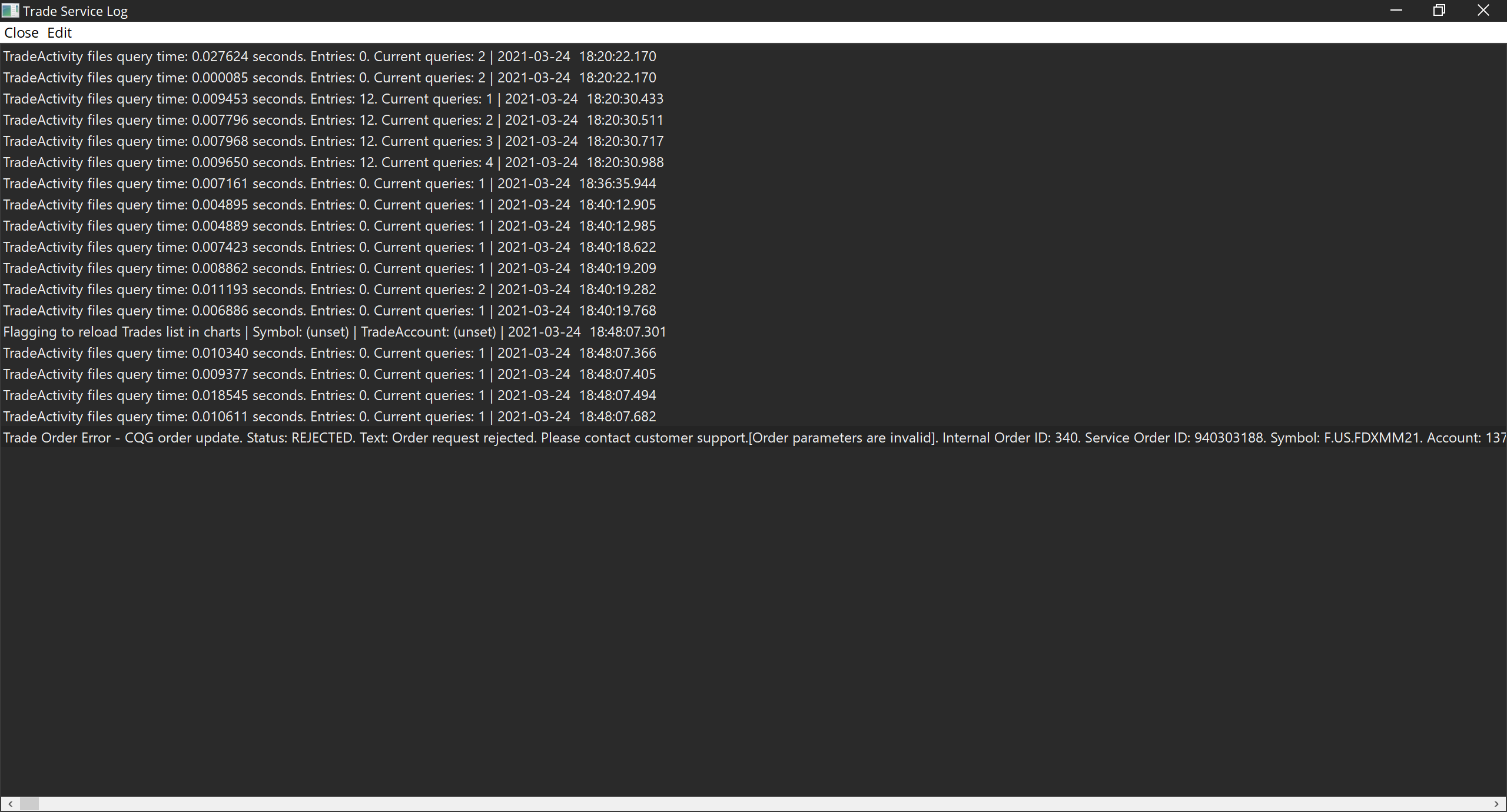

Channas - Posts: 32
Hi John,
I have enabled CQG order routing with AMP.
After receiving my new credentials I set it up from step 6 - 13 CQG Trading Platform Service: Setup Instructions
However, I placed an order but it's rejected. Please see a screenshot.
image2021-03-25_04-49-05.png / V - Attached On 2021-03-24 17:53:25 UTC - Size: 141.18 KB - 415 views
[2021-03-24 19:11:28]
One of the things to check is that your Time in Force is set correctly. Refer to the following:
Basic Trading and the Trade Window: Main >> TimeInForce (Time in Force):
But you would need to check with your broker to find out exactly why that order was rejected.
[2021-03-25 08:43:11]
Channas - Posts: 32
Hi John,
technical support from AMP fixed the problem for me. Thank you.
