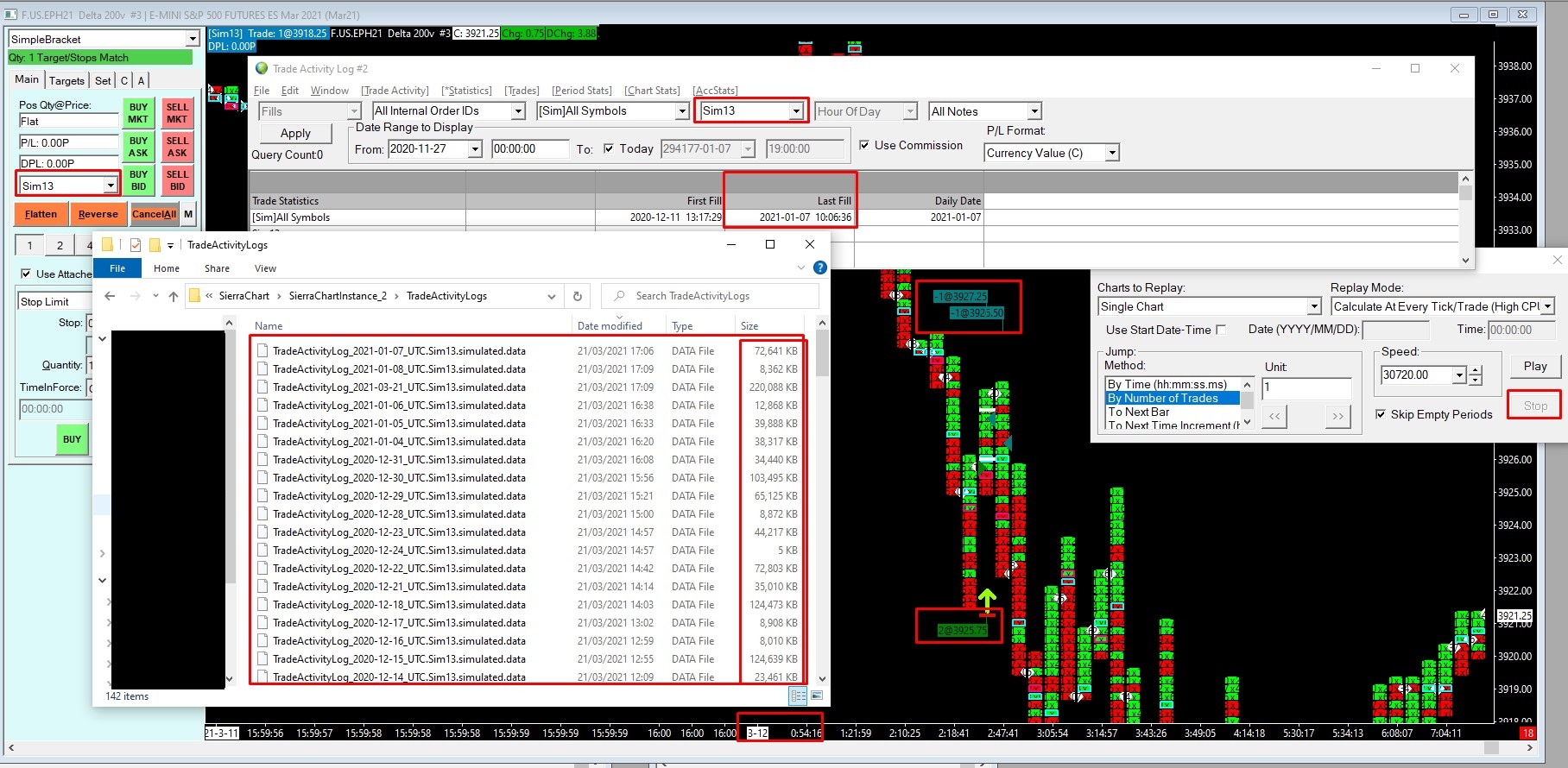

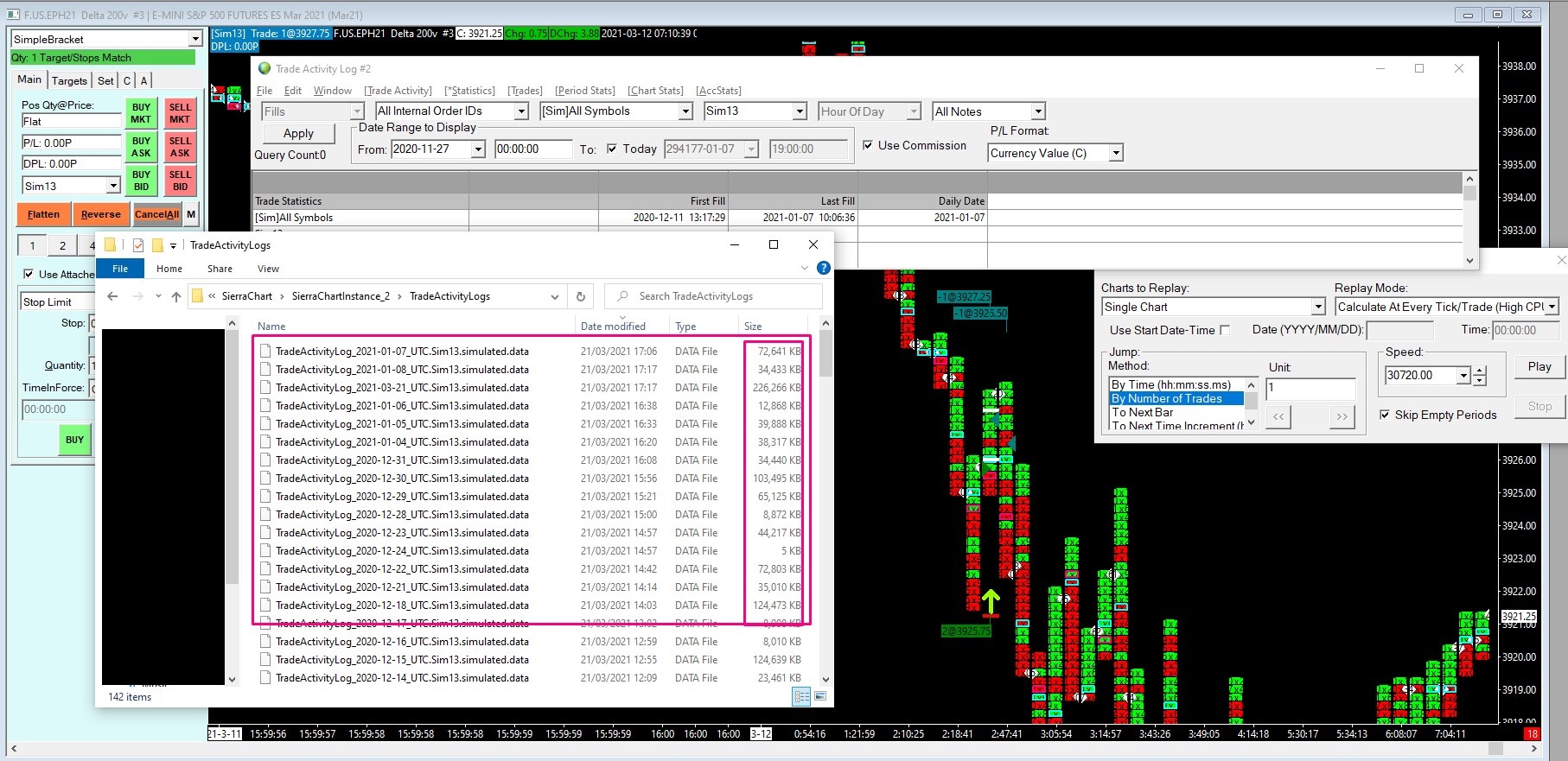

pls check the attached screenshots
1. I completed 3 months (ESH21) replay on x30720 speed calculating tick by tick over 200 delta bars
2. I opened the activity log but it ends on 01/07/21 while you can see a fill on the chart on 03/12
3. When checking the path, I see there are a lot of files there and their size is growing although the replay was done a while ago
I hope you could clear things up:
1. why the activity log last fill is not aligned with the chart fill
2. why I have so many files in the tradactivitylogs
3. why these files are growing
thanks

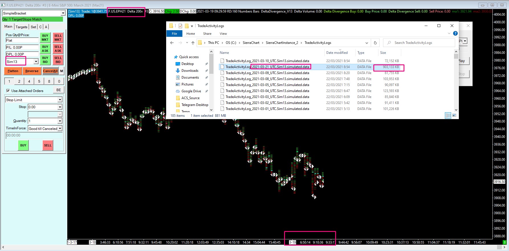

since yesterday, files are keep updating....
check the attached:
how can it be that I have sim data for a day if there is no data for that future contract (ESH21)
now, the last trade I see in the activity log is on 03/09/2021. so I used a speed of 30000 to replay but the results are getting on a speed of 0.0003
imageScreenshot_557.jpg / V - Attached On 2021-03-22 06:57:05 UTC - Size: 286.93 KB - 342 views

The one file that is almost a gigabyte is way too large and you need to delete it. It seems like what you are doing is running replay after replay without clearing the Trade Activity for the trading account.
At this point just delete those large files. They are way too large.
You need to go to the first tab of the Trade Activity Log, "Trade Activity" to definitively see all of the fills. The other tabs, due to fill matching logic could potentially filter out fills especially if there are fills from different replays all intermingled. Refer to:
Trade Activity Log: Trade Activity Data Editing Menu Commands (Trade >> Trade Activity Log)
Also select a specific symbol on the Trade Activity Log, not All Symbols, and press the Apply button. You will definitely see all the fills on the first tab based upon the date range and other settings.
Date Time Of Last Edit: 2021-03-22 13:52:25
[2021-03-22 14:02:47]
