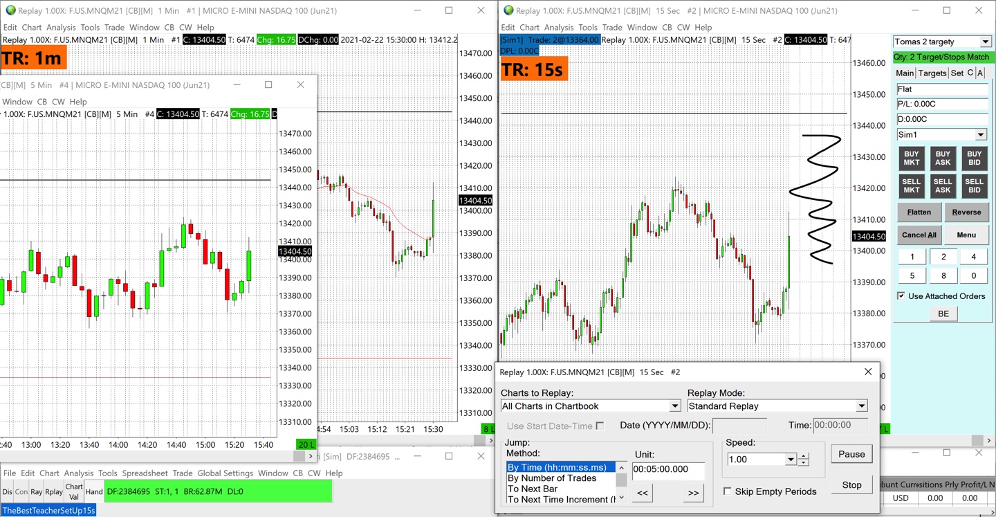

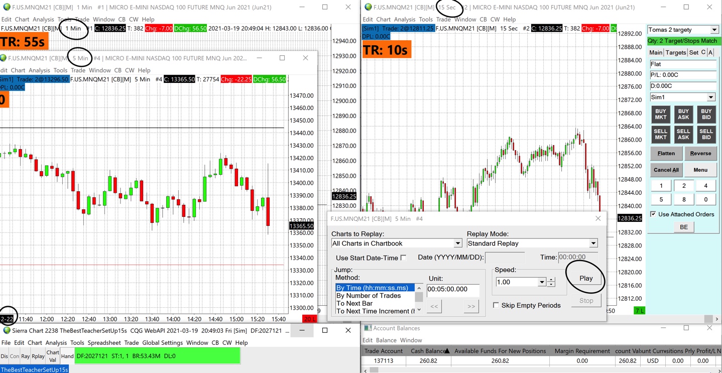

[2021-03-19 20:12:27]
Jiri Presl - Posts: 4
I do it still in the same way. Before I changed from TT to CQG order routing only I experience replay normal function. But after this change it doesn't work.
I open the Sierra Chart platform. I use routinely 3 charts 15s/1min/5min. Live it works well - bars tick.
When I want to replay previous data, I drag the timeline on 5 min chart and choose the specific date in the past.
After that I open RPlay command window - you can see it on the screenshot.
When I press Play button, it reload the data but bars do not tick and there is a strange disruption in grid - seen on the screenshot.
imageObrázek 19.03.2021 v 20.51.jpg / V - Attached On 2021-03-19 19:56:57 UTC - Size: 480.29 KB - 560 views
imageObrázek 19.03.2021 v 21.01.jpg / V - Attached On 2021-03-19 20:02:08 UTC - Size: 517.6 KB - 428 views
[2021-03-21 20:00:46]
When I simply change Data/Trade service settings to SC Futures Order Routing Data, then everything works well. Replay work normally, fluently. But under CQG WebAPI it doesn't work or very very slowly respectively.
[2021-03-22 14:05:45]
We want you to fully re-download the data for the symbols being replayed for all contract months by following these instructions:
