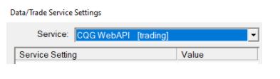

I recently obtained Live real time data feed through AMP CQG into my Sierra chart.
Setup setting as attached to Sierra.

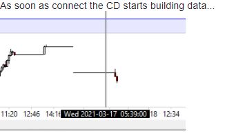

All OK except the fact Cumulative delta only builds when connected. The past data is a straight line? See attached.
Can you please help..
When I select SC Data (delayed) the Cumulative delta past displayed, and its only when on Live feed....

[2021-03-17 15:28:19]
John - SC Support - Posts: 48279
That is related to the limited historical data that is available from CQG.
We recommend using the Denali Exchange Data Feed, which you have already seen in the Delayed form. Refer to the information here:
