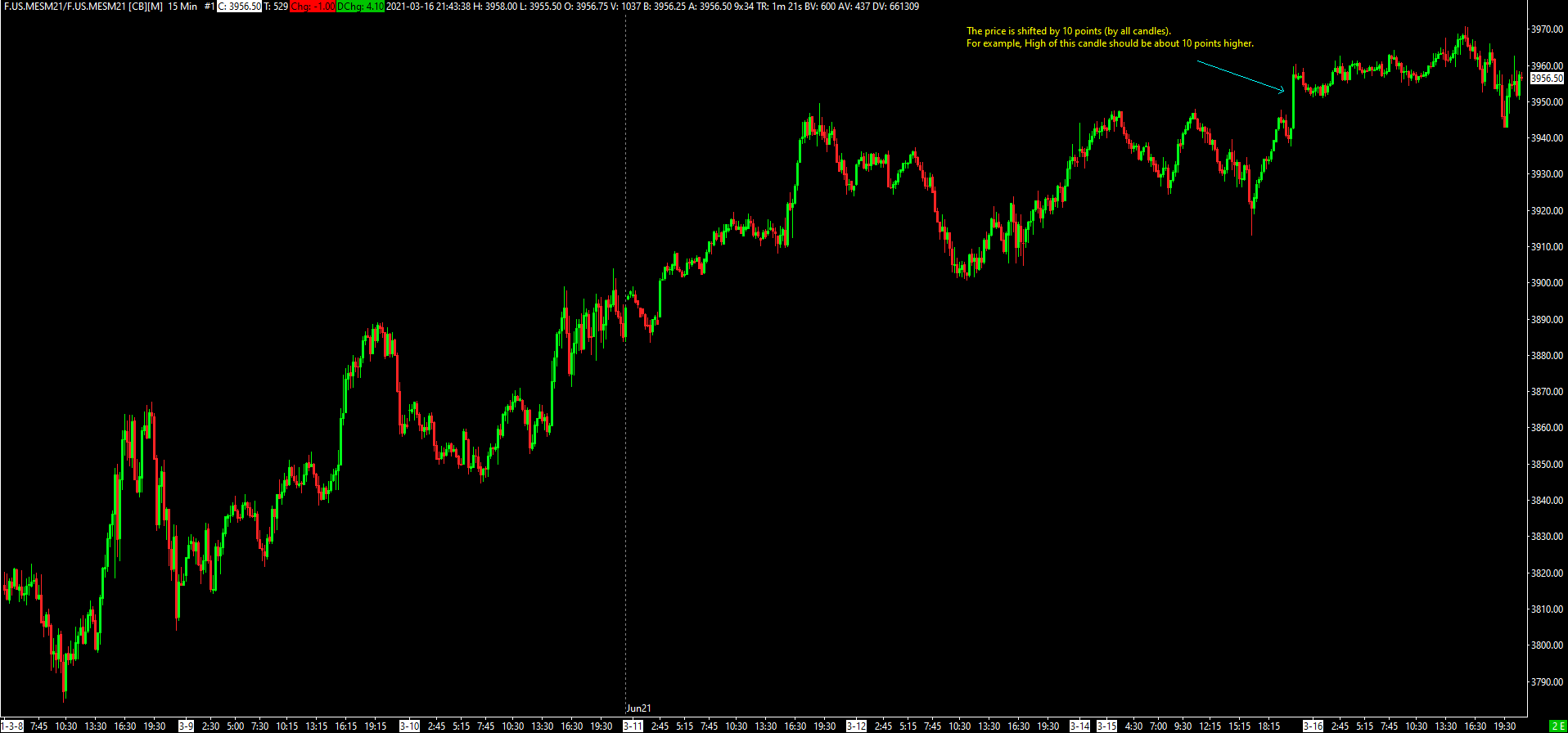

[2021-03-16 20:44:56]
User99275 - Posts: 16
http://www.sierrachart.com/image.php?Image=1615927420532.png
[2021-03-16 21:16:29]
John - SC Support - Posts: 48279
Is it just that one bar?
What are the OHLC values of that bar?
When we look at that bar (03-15-2021 14:45:00 CDT) in your image versus what we have, they look very similar. And we compared the data we have against Yahoo Finance and they are exactly the same for that bar.

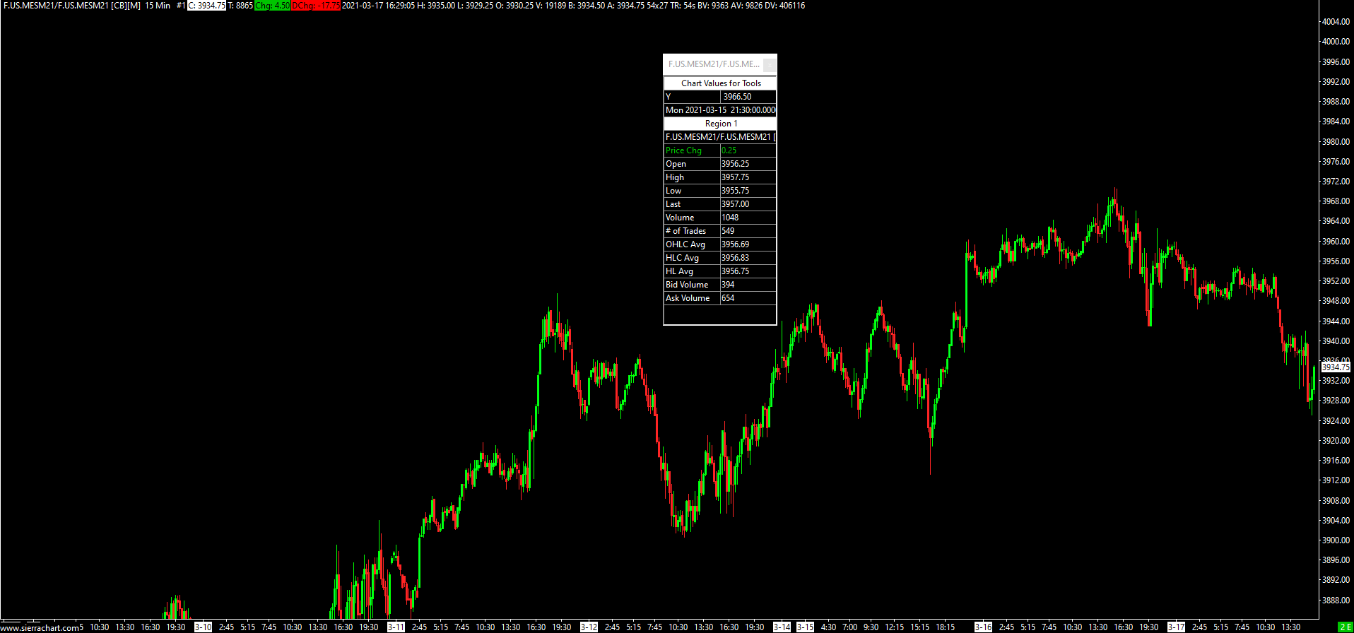

Here is screen of that bar with Chart Values:
http://www.sierrachart.com/image.php?Image=1615994165684.png

All bars are shifted. Mostly high, but sometimes other values. Mostly by 10 points.
I tried delete and redownload data, but it didn't help. Update symbol from server also not.
Thank you for reply

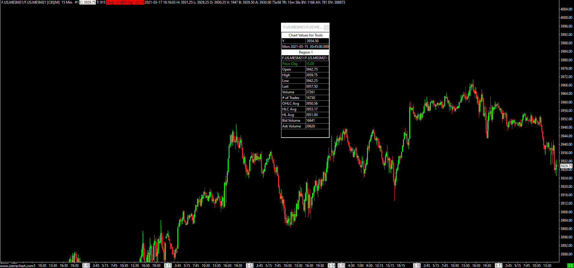

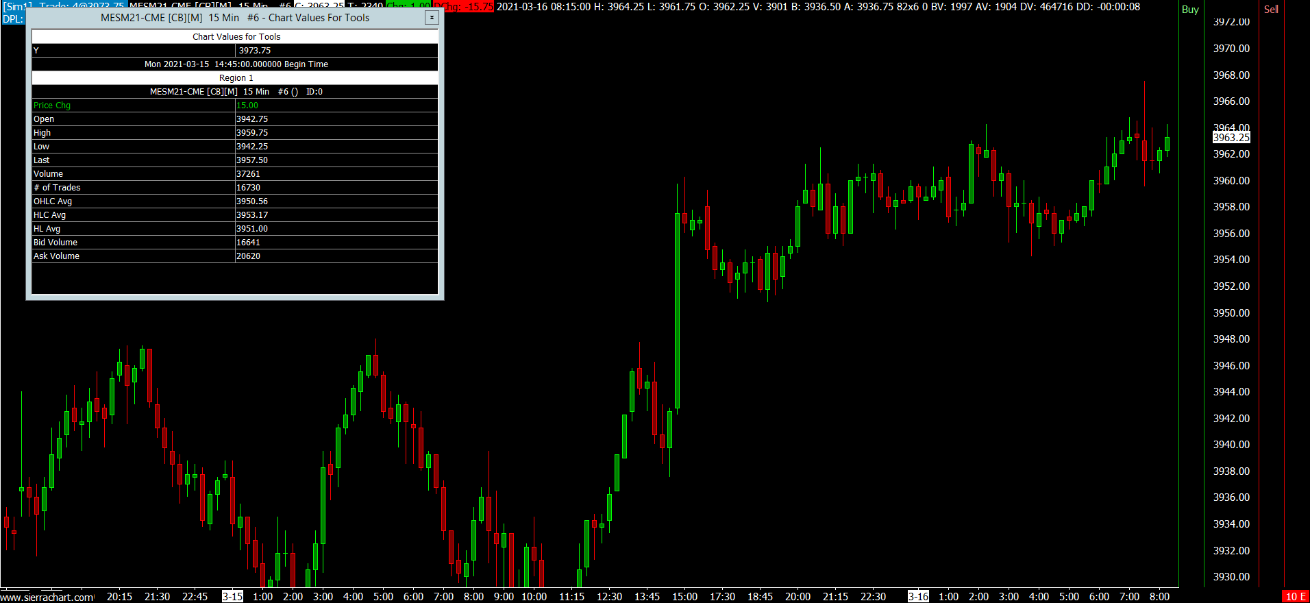

We think you are comparing to the wrong contract.
Here is what we see for that particular bar in image 1615994165684 on our system:
http://www.sierrachart.com/image.php?Image=1615998190932.png
Which matches exactly what you have in your image.

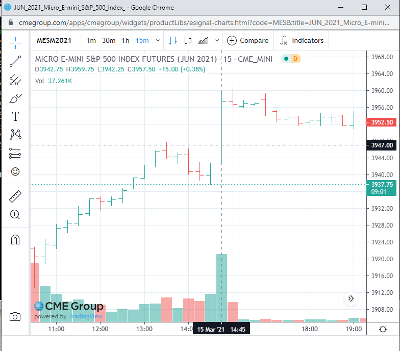

And the attached image shows the information from the CME Group for the same bar for the same MESM21 contract. Which matches exactly to your data and our data.
So all 3 are showing the exact same information.

Yes, you are right. I am sorry. I looked at wrong contract month on cme website.
