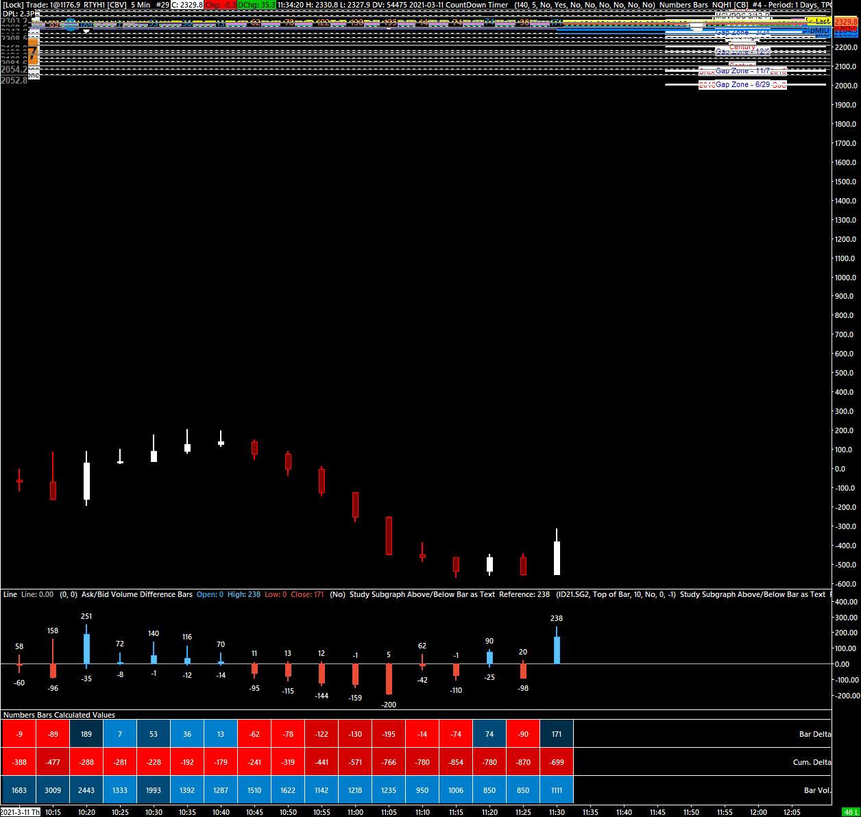

Did you follow all of the instructions and set the Scale Range to Automatic for the chart? There simply should not be a problem if that is the case and all of the instructions are followed.
Post an image of the chart when you have the issue so we can understand this better:

http://www.sierrachart.com/image.php?Image=1615480468542.png
[2021-03-11 17:29:35]
The reason you are having the problem is that you have a study in Region 1 that has data down between 0 and -600. That is what those bars that you are easily seeing are. You need to remove that study from Region 1 and put it into it's own region. Refer to the following:
Chart Studies: Settings and Inputs Tab >> Chart Region
